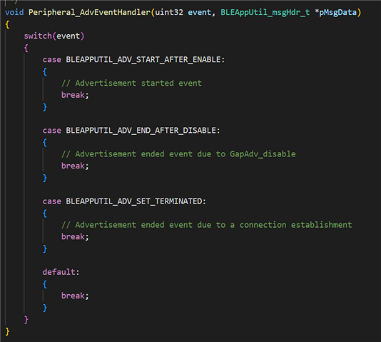

I have a project using limited ADV duration, after the duration expires the BLEAPPUTIL_ADV_END_AFTER_DISABLE event will be invoked. Meanwhile when a connection is established, BLEAPPUTIL_ADV_END_AFTER_DISABLE event will also be invoked. Is there a way to tell this event is invoked because of the expiration of ADV duration or the connection establishment?
The reason I want to seperate the event is that I have different functions to call in these different cases. For example, I will call function A after ADV duration expires, and call function B after connection establishes. However since BLEAPPUTIL_ADV_END_AFTER_DISABLE event is always ahead of BLEAPPUTIL_LINK_ESTABLISHED_EVENT, function A will always be called regardlessly. What's the suggested approach to handle this use case?

  • Hi !
    In the latest SDK, these are handled by two different events GAP_EVT_ADV_END_AFTER_DISABLE and GAP_EVT_ADV_SET_TERMINATED:
    In the BLEAppUtil API, those events are linked respectively to BLEAPPUTIL_ADV_END_AFTER_DISABLE and BLEAPPUTIL_ADV_SET_TERMINATED.
    You should be able to set those two events in the peripheral or broadcaster event handler, and then filter for those events in the event mask of the event handler
    I have made these screenshots on the latest SDK. Could you share with me the version of the SDK you are using ?
    Kind regards,
    Maxence
  • Hi Maxence,
    I am using the latest SDK and I saw these events, but I found that BLEAPPUTIL_ADV_END_AFTER_DISABLE will be invoked when the advertisement is terminated due to a connection. Can you check if you see the same at your side?

  • Hi Maxence,
    At my side BLEAPPUTIL_ADV_SET_TERMINATED triggers when a connection is established(not disconnected), BLEAPPUTIL_ADV_END_AFTER_DISABLE triggers when the advertisement terminates due to duration expiration or a connection is established.

  • Hi !
    I think I found the issue. The events are sent correctly, the issue stems from the behavior of the basic_ble example. In app_peripheral.c, you will find the Peripheral_GAPConnEventHandler function. This function listens to GAP events, and when a connection establishes, it stops the advertising through the GapAdv_disable function. This is the function that sends the BLEAPPUTIL_ADV_END_AFTER_DISABLE event.
    In your use case, instead of listening to BLEAPPUTIL_ADV_END_AFTER_DISABLE and BLEAPPUTIL_ADV_SET_TERMINATED, you may instead listen to BLEAPPUTIL_ADV_END_AFTER_DISABLE and BLEAPPUTIL_LINK_ESTABLISHED_EVENT (be careful, these events are of different type, and use two different handlers).
    What you can do is change the code inside Peripheral_GAPConnEventHandler to inform the Peripheral_AdvEventHandler handler that the next BLEAPPUTIL_ADV_END_AFTER_DISABLE event is from a connection and not an actual call to GapAdv_disable.

  • Hi Maxence,
    I forgot to sync with you that I have already tried to comment out the GapAdv_disable in Peripheral_GAPConnEventHandler, but the BLEAPPUTIL_ADV_END_AFTER_DISABLE event is still triggered when a connection is established. I believe it is the design of the BLE stack, which does not seperate the ADV termination reason. Can you help check if this is the case?
    Shuyang
    I'm able to reproduce your issue even after commenting the function. I will try to find the root cause or report this as a bug, and find a workaround in the meanwhile.

  • Hi !
    I found a solution to your issue. You can change your Peripheral advertisement handler function to the following :
    void Peripheral_AdvEventHandler(uint32 event, BLEAppUtil_msgHdr_t *pMsgData)
        switch(event)
            case BLEAPPUTIL_ADV_START_AFTER_ENABLE:
                MenuModule_printf(APP_MENU_ADV_EVENT, 0, "Adv status: Started - handle: "
                                  MENU_MODULE_COLOR_YELLOW "%d" MENU_MODULE_COLOR_RESET,
                                  ((BLEAppUtil_AdvEventData_t *)pMsgData)->pBuf->advHandle);
                break;
            case BLEAPPUTIL_ADV_END_AFTER_DISABLE:
                if(linkDB_NumActive() < linkDB_NumConns())
                    MenuModule_printf(APP_MENU_PROFILE_STATUS_LINE, 0, "Adv status: Ended - Function A");
                else
                    MenuModule_printf(APP_MENU_PROFILE_STATUS_LINE1, 0, "Adv status: Ended - Function B");
                break;
            default:
                break;
    This shows you how to differentiate when the advertisement change because of a connection or because of the advertisement expired.

  • Hi Maxence,
    This works for my use case, thanks for the support!
