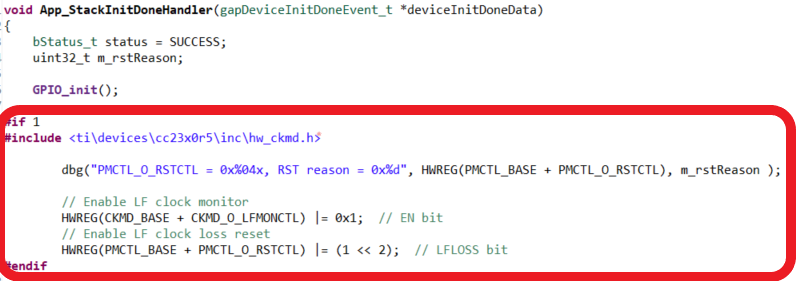

By TRM 6.7.2,  we try to enable LF Loss detection and enable LF clock loss reset, and the following is the code:
void enableLFClockLossDetection(void) {
    // enable  LF clock monitor
    HWREG(CKMD_BASE + CKMD_O_LFMONCTL) |= 0x1;  // EN bit
    // enable LF clock loss reset
    HWREG(PMCTL_BASE + PMCTL_O_RSTCTL) |= (1 << 2);  // LFLOSS bit

    The following is my customter's test result:
    The current testing results show that placing the code at the beginning of the program and enabling custom MCUBoot signing causes the program to freeze.
    However, moving the code to the end of the App_StackInitDoneHandler() function or using the root-ec-p256.pem signature file provided by TI resolves the issue.
    Placing the code before App_StackInitDoneHandler() + root-ec-p256.pem ------ OK
    Placing the code after App_StackInitDoneHandler() + custom .pem ------ OK
    Placing the code before App_StackInitDoneHandler() + custom .pem ------ NG
    Please help to provide comments.
    Thanks.
    If they run the code before App_STackInitDoneHandler, but include it in a critical section do they still see it fail?
    Nima Behmanesh
  • Hi Nima,
    Update the test result:
    Base on the suggestion that you provide ,  my customer place the code before App_StackInitDoneHandler() + custom .pem,
    the test result is still fail.
    The following is the code:
        // Disable interrupts
        halIntState_t state;
        HAL_ENTER_CRITICAL_SECTION(state);
         ...     <----- enableLFClockLossDetection();
         // Allow interrupts
         HAL_EXIT_CRITICAL_SECTION(state);
    Besides,  In the case "Placing the code after App_StackInitDoneHandler() + custom .pem ------ OK",
    my customer try this solution at production line last Friday, the found the pass rate is only 33%.

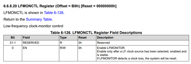

    1. CC2340 TRM said:
       "When the LF clock loss feature is enabled by setting the PMCTL.RSTCTL[2] LFLOSS bit and CKMD.LFMONCTL[0] EN bit"
      Can the register " PMCTL.RSTCTL[2] LFLOSS bit and CKMD.LFMONCTL[0] EN bit"  be controlled in the code?
    2.  Will system default enable LF clock loss feature ?
    3. What is the right timing to enable/disable LF clock loss feature ?
    Please help provide comments.
    Thanks.
    Yes, both of those are R/W, so they can be controlled in the code.
    Based on what I see in the TRM, no, the system will not default to enable:
    You can see that it's set to 0 by default, so it's disabled.
    The right timing to enable/disable the LF clock loss feature is after the LF clock source has been selected, is running (i.e. enabled) and is stable. This is from the above image of the register description.
