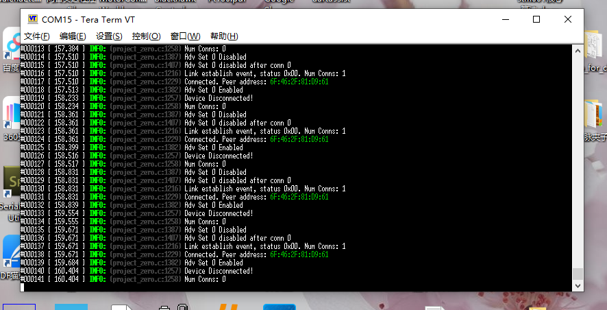

I followed the instructions in the TI BLE5 Stack Quick Start Guide and burned my recompiled project_zero into my development board. The SDK version I used was 8.31.00.11, and the compiler was iar9.40. After burning and running it directly using the emulator, I was able to connect and operate normally using TI STARTER on my phone without disconnecting for a long time. However, pressing the reset button on the development board to reset or power off will result in the situation shown in the picture, where Bluetooth automatically disconnects after connecting, and then continues to reconnect and disconnect, repeating the process. May I ask how to solve this problem?

  • Thanks for you relpy.
    I used the app LightBlue for connection, and it was the same situation.

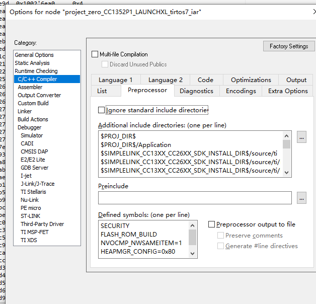

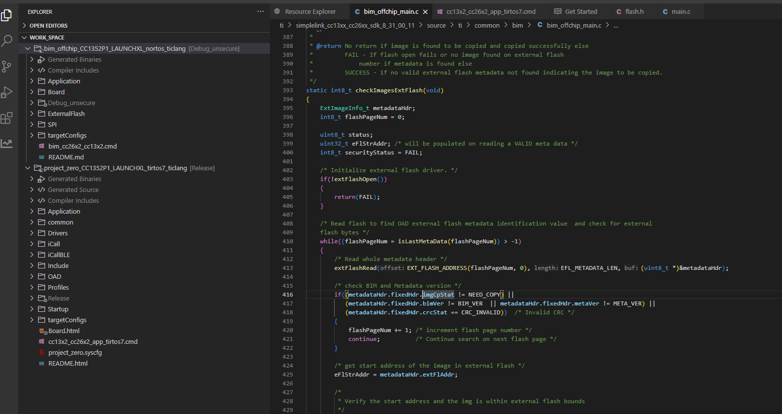

    After cold start, everything is connected normally and there will be no automatic disconnection. So I guess it's because the version I compiled myself doesn't match the BIM hex file. The BIM firmware version I burned is bim_offchip → debug_unsecure, and the define setting of the version I compiled myself is shown in the picture below. Is it possible that there is a mismatch between BIM and project_zero settings causing this issue. Because if I run Project Zero directly with the emulator and the BIM jumps off and runs directly, everything is normal at this time.
  • I found the reason for the automatic disconnection of Bluetooth. I completely deleted the flash and only burned it into the BIM. After powering it back on, there was also a Project Zero app running, and the Bluetooth connection also automatically disconnected after being connected. So I can confirm that the BIM did not jump to the app I was burning after running, but instead ran my own app, which caused the Bluetooth to automatically disconnect, but I don't know how to solve this problem.

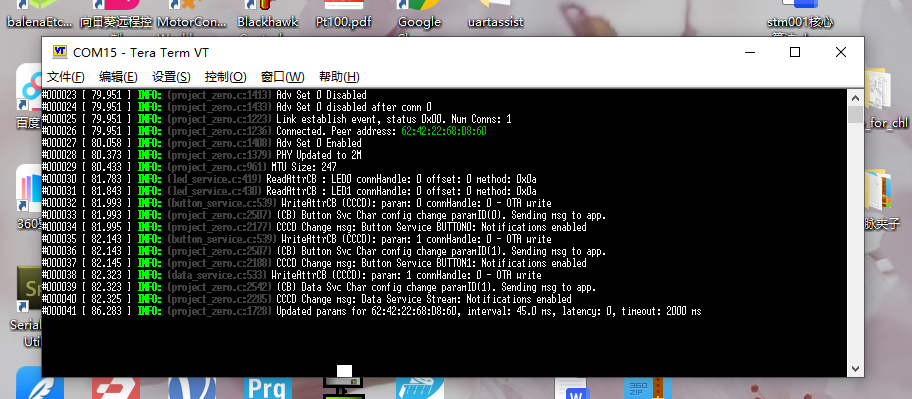

    5. Using the mobile phone to launch the Ti starter app allows for stable and normal connection to the development board. The following figure shows the information displayed on the serial port terminal.

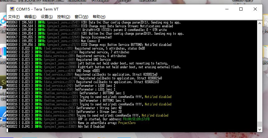

    6. Next, the ti starter will exit the connection and cold start the development board. The development board will output the following restart message, indicating successful startup.
    7.When using TI STARTER to connect again, the connection will automatically disconnect, as shown in the serial port information in the following figure.

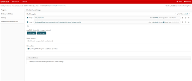

  • Hi !
    The way you are flashing in UniFlash seems incorrect, since you need to also flash the BIM. The way to flash both the BIM and the project_zero files is to click the "plus" button above "Available actions". The files must first be the BIM and then the Project_zero firmware, like this :
    Kind regards,
    Maxence

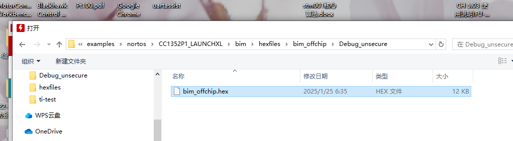

    Secondly, can you tell me which BIM hex folder and which HEX file are suitable when I burn the official project zero?
    Because the setting options in the official project zero that I am compiling now are shown in the following figure, I found that there are pre-defined security and flash ROM related settings inside.
    Thanks a lot!

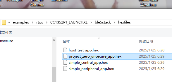

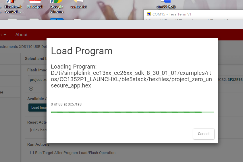

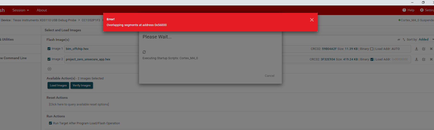

  • I encountered an error while burning according to your example image. The following image will provide an explanation.
    1.Select the BIM hex file, the file path is shown in the following figure
    2. Select the officially compiled project zero hex file, with the file path shown in the following figure
    3. The error messages that occur during burning are shown in the following figure
  • Hi x y,
    I apologize for the confusion in resources, as project_zero_unsecure_app.hex is a combined BIM + BLE application file (known as a production image).  If you need to load both the BIM and BLE application separately then you should be using the .bin file generated from your project_zero workspace.  Please use Uniflash with the "Off-chip" instructions from this SimpleLink Academy Lab:
    https://dev.ti.com/tirex/content/cc13xx_cc26xx_simplelink_academy_8_31_00_00/_build_cc13xx_cc26xx_simplelink_academy_8_31_00_00/source/ble5stack/ble_enhanced_oad_fundamentals/ble_enhanced_oad_fundamentals.html#oad-target-setup
