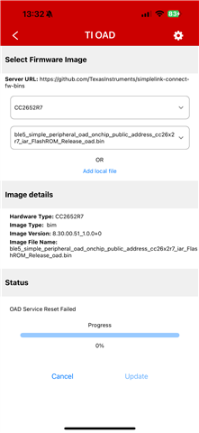

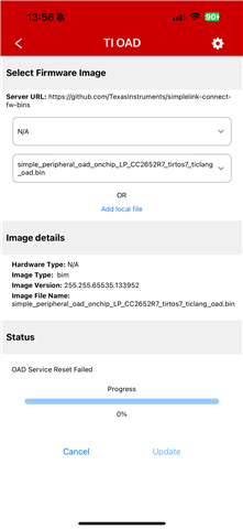

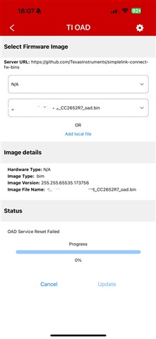

I am developing a firmware with on-chip OAD added, similar to the post (LAUNCHXL-CC26X2R1: CC2642R1 BLE OAD : simple peripheral OAD ON Chip, the OAD process didn't start - Bluetooth forum - Bluetooth®︎ - TI E2E support forums), I can use btool to do the OAD update successfully, but failed with the simple link connect app, which it always mentioned 'OAD reset failed'. After that I found that the device entered the persistent app, I can connect it again to continue my update.
But when I use btool, OAD was successful when every time I tried to update.
I am using 'simplelink_cc13xx_cc26xx_sdk_7_40_00_77' for my CC2652R7, could you help with this? Thanks a lot!

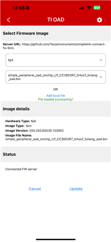

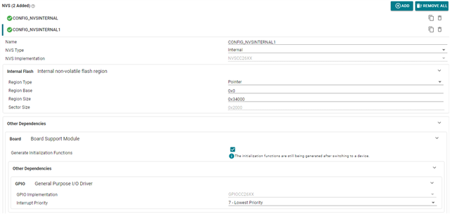

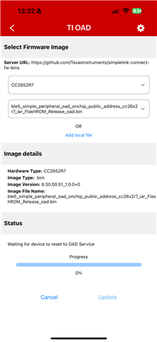

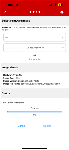

  • And here is the screenshot, I try to update with my firmware which can be successfully updated in btool:
    After the failure, I found that the device is advertised as persistent App:
    In this situation, OAD progress started
  • Hi !
    The error you're seeing happens when the device rebooted but the SimpleLink application could not re-connect to the device (See code responsible for this error message here). There could be multiple reasons why the SimpleLink app is unable to re-connect, the first one that comes to mind is that the pairing information in the NVS for your application and for the permanent app are not the same.

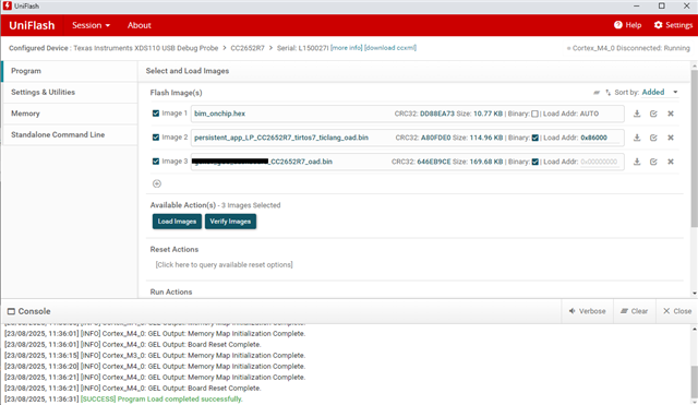

    - Show me how you flash your application in UniFlash ?

    3)Here is how I flashed the application. I followed the rule :
    CC2652R7 (TI BIM):
    Onchip OAD:
    0x00 -> ble5_simple_peripheral_oad_onchip_public_address_cc26x2r7_iar_FlashROM_Release_oad.bin
    0x86000 -> ble5_persistent_app_cc26x2r7_iar_FlashROM_Release_persistent_oad.bin
    AUTO(0xae000) -> ble5_bim_onchip_cc26x2r7_iar_Release_bim.hex
    from simplelink-connect-fw-bins/CC2652R7/README.txt at main · TexasInstruments/simplelink-connect-fw-bins · GitHub

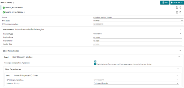

    4)Her is the NVS settings which mention from simplelink_academy

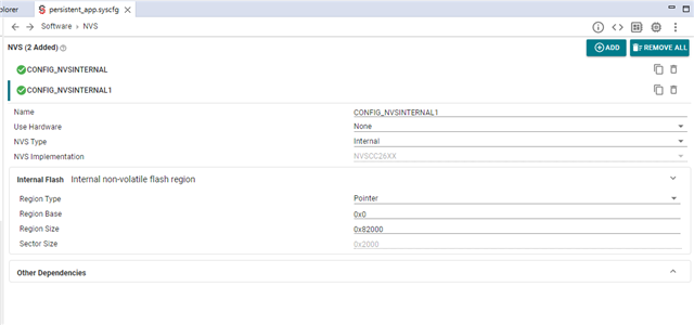

  • Hi Jermyn !

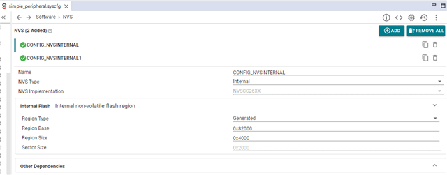

    I think I have the solution to your issue. The SLA was made for the CC26X2R1_LAUNCHXL devices as the example. As you correctly pointed out, the flash memory layout for the CC2652R7 devices is different :
    - The user application flash starts at 0x0
    - The permanent app is from 0x86000 to 0xAE000
    - The BIM is from 0xAE000 to the device's end (0xB0000)
    The reason why the layout is different is to give you more space for the user application, since the CC2652R7 has more flash than the the CC26X2R1 devices.
    When a OAD instruction is given to the user application, it reboots into the permanent application. It must then reconnect to the central that gave this instruction over BLE. To seamlessly reconnect, it must used the bonding information from the user application, which are stored in the NVS. The NVS has to be shared between the permanent app and the user application in order for the permanent app to correctly bond.
    On the SLA for the CC26X2R1_LAUNCHXL devices, the address of this shared NVS is from 0x34000 to 0x38000. However, for the CC2652R7, this shared NVS is from 0x82000 to 0x86000.
    In the screenshots you shared for your application, both the NVS values are wrong, as the need to follow the values specific to the CC2652R7, which are as follows :
    This should fix your issue. If you want a reference example of how to do OAD for your device, you should look at the SysConfig values for the following examples :
    - persistent_app_LP_CC2652R7_tirtos7_ticlang
    - bim_onchip_LP_CC2652R7_nortos_ticlang
    - simple_peripheral_oad_onchip_LP_CC2652R7_tirtos7_ticlang
    Kind regards,
    Maxence

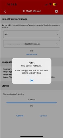

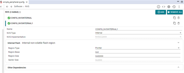

  • Hi Maxine,
    I found that there is still failed to update in the simplelink connect app.
    As you mentioned, I changed the NVS address, and I checked that the persistent app NVS address is the same as you mentioned and is the same as what I used in my firmware.

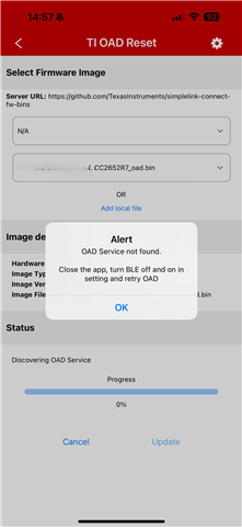

    But this time when I tried to update via the app, it shows this

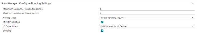

    I also review the syscfg in the out of the box simple_peripheral_oad_onchip_LP_CC2652R7_tirtos7_ticlang example and most of them should be the same. But I change the pairing mode for our own purpose:

  • Hi !
    Does the device reboot into persistent app and can you see it on your SimpleLink Connect app ? If yes, do you see the OAD service in the app when connecting to the persistent app ?
    Kind regards,
    Maxence

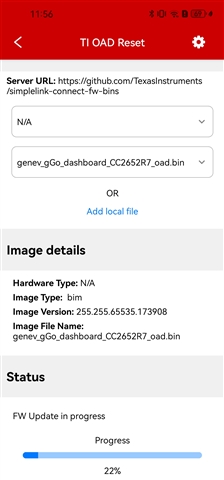

    Yes the device reboot into persistent app, I can select the OAD update, but this time when I try to update from persistent app, it first ask me to manually reset the device, after I reset it, then it said the same ‘OAD service not found’.

  • Hi Maxence.
    Here is the screenshot for NVS in persistent app:
    Here is the NVS address in my firmware:

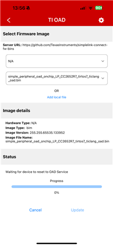

    But this time I have a finding:

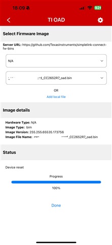

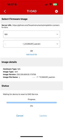

    After I try to update from my application, the interface switch to this:
    if I continue to update, it will show
    then after resetting it will show:

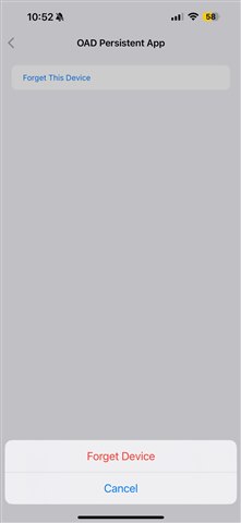

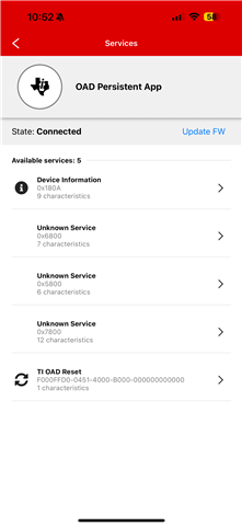

    But then I found that the interface is weird, the name is 'persistent app' but the services are the same as my own application.

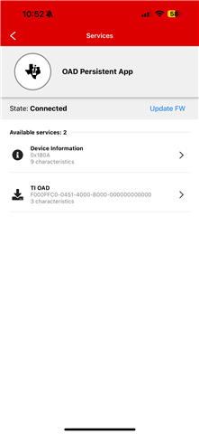

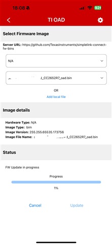

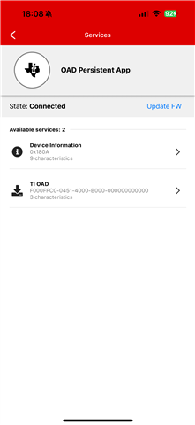

    Then I try to forget the device and reconnect, it becomes the real persistent app interface:
    This time the update is successful:
    I also found that for my application, the service is:
    but for persistent app, it is:
    This is what I found so far, hope the situation is clear enough. Thanks a lot.

  • Hello Jermyn,
    Maxence is out of office for the next few weeks, so I will continue supporting this thread.
    I have a few questions:
    1. Is this behavior consistent? As in, are you able to easily replicate it?
    2. Is this behavior seen with android devices? The reason I ask is because apple devices sometimes cache information, which may change upon performing an OAD update.
    Tarek D
  • Hi Tarek,
    Thanks for the reply.
    1) Yes, this is the same when every time I use the OAD update.
    2)For my android device, it first asked me to manually reset the device, after that the progress started and was successful.
    Jermyn
  • Hello Jermyn,
    Thank you for answering my questions! The manual reset I believe is expected behavior. However, as for the IOS issue, I fear this issue may be on the IOS side, where it's caching unnecessary information, which would explain why it starts working after you "forget" the device, which removes all bonding information from the phone.
    Please let me know if you have any more questions!
