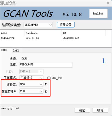

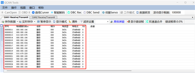

When I use CC2745r10 CAN-FD, I do not send any data to can bus, but I found can tools recv ID0 , and DLC is 0 too.
can setting:
can tool device setting:
error happen:

    I did not send data to the CAN bus through the CAN module of CC2745, but the CAN bus received a packet with ID 0, suspecting that CC2745 was sent by the underlying driver under special circumstances.The following figure shows the data packets received by the CAN bus.

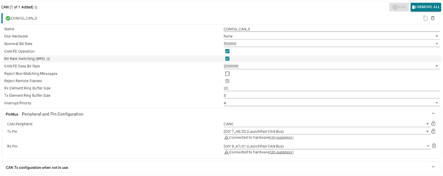

    The CC2745 CAN driver does not send any data packets without the developer sending them explicitly. This activity on the bus may be coming from another device or the CAN driver is misconfigured.

    1.CAN system only have CC2745 and Gcan tool, and GCAN is only used as a receiver. Previously, using cc2642+TCAN4550 and Gcan tool did not have this issue.
    2.CAN driver is misconfigured?For example, which configuration may cause this issue?The following figure shows the configuration of CAN,
