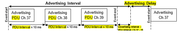

Hi, Ti support
I suspect point PDU data.
From picture, Each PDU channel (37, 38, 39) inside PDU have data advertisement legacy only and then advertisement long range operate in other channel or PDU Ch.37,38,39 advertisement both legacy and long range within channel?
Thank,
Vasu Khwanyuen

    I understand channels 37,38,39 are used for advertising. but detail about legacy data and long range data of advertisement, I suspect it operate within channel of advertising (37,38,39) or not?

  • Hello Vasu,
    Thanks for the clarification! Legacy advertisements operate purely on the 3 primary advertising channels: 37, 38,39. However, long range advertisements (AKA extended advertisements) can move advertising payloads onto secondary advertising channels.

    So, remain channel of Secondary advertising channels It is long range advertisements, but it fixed channel or not for long range advertisements(channels 0 - 36) or all channel of secondary advertising?
