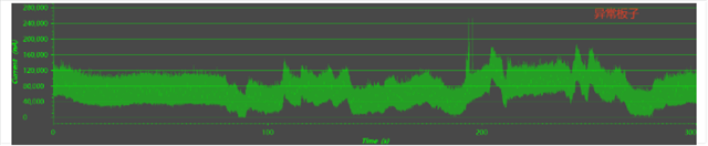

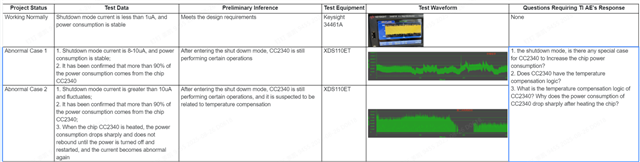

I have found that some chips have power consumption issues and need help to analyze them. The test data is as follows:
SDK:8.10
question:

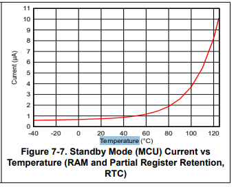

1. the shutdown mode, is there any special case for CC2340 to Increase the chip power consumption?
2. Does CC2340 have the temperature compensation logic?
3. What is the temperature compensation logic of CC2340? Why does the power consumption of CC2340 drop sharply after heating the chip?

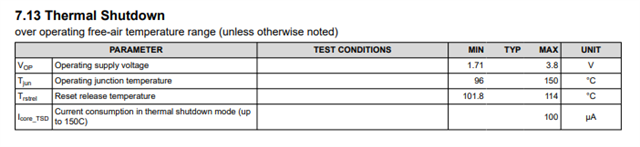

    Temp compensation for this device ensures RF output power is consistent over temperature and does not apply to power consumption when in shutdown mode. It is expected for current to increase when temperature increases. Also keep in mind that the CC2340R52-Q1 device has a thermal shutdown feature.
  • 1.There are a total of 1000 boards, with 3 boards in Case 1 and 20 boards in Case 2.
    2.Configure the SWD interface as a digital input or low-level output, and the abnormal shutdown current phenomenon in cases 1 and 2 disappears, with a current less than 200nA.
    3.External 10K resistor pull-down was applied to the clk and data signals of SWD, but the abnormal shutdown current still exists in cases 1 and 2.
    question:
    1. Why can't SWD be configured as high impedance? It must be configured as low level to ensure that the chip shutdown current is normal

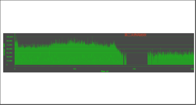

    2. What is TI's recommended configuration for GPIO, SWD, and crystal oscillator input/output pins of CC2340 in shutdown mode
    3. When the SWD is configured with high resistance, the shutdown current will dynamically fluctuate. At this time, heating the chip with a hot air gun (less than 80 degrees Celsius), why does the sleep current suddenly decrease? Is there any temperature compensation mechanism inside the chip?

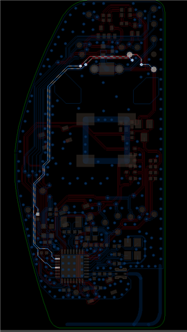

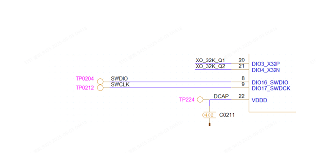

    By default SWDIO has an internal pull-up and SWCLK has an internal pull-down enabled. We don't recommend adding an external pull-down to SWCLK as this will increase your current consumption due to the internal pull-up on SWCLK.
    On your board design, what do you have connected to these 2 pins (SWCLK and SWDIO)? Can you share your schematic? Knowing what is tied to these pins may explain why configuring these pins to high impedance results in abnormal case 1 or 2.
    Andrew

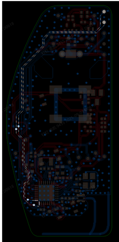

  • Our board's SWD pin is not connected to anything, it only leads out the test point

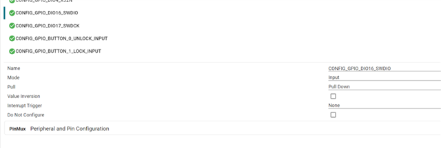

  • simplelink_lowpower_f3_sdk_8_10_01_02
  • By configuring SWCLK and SWDIO as input pull-up and disabling UART's TX and RX through software, the above problem can also be solved.

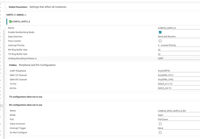

    You also mentioned that you had to disable your UART pins. Can you share what you have tied to the UART lines and how you have them configured in sysconfig?

  • GPIO_setConfig(CONFIG_GPIO_UART2_0_TX, GPIO_CFG_NO_DIR);
    GPIO_setConfig(CONFIG_GPIO_UART2_0_RX, GPIO_CFG_NO_DIR);

    3. Are the UART TX and RX lines floating during your testing?
    4. Was your SW changing the configuration of the UART lines in the application before you made the change to disable the GPIOs? If so what configuration change was the SW applying previously?
