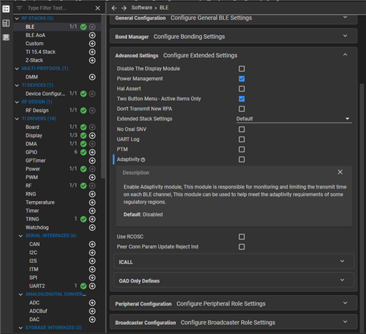

I am using BLE-Stack5 with CC2642R.
I know the BLE specs call for adaptive frequency hopping (AFH), but is this actually enabled in the BLE-Stack5 sample apps, etc.?
Or is there a function or setting equivalent to AFH?
