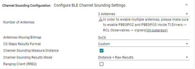

  • Hi, Isaac
    I have configured the dual-antenna setup according to the documentation specifications, with both CC2340 and CC2745 following this configuration. The TX power is set to the default value of 0x80.
