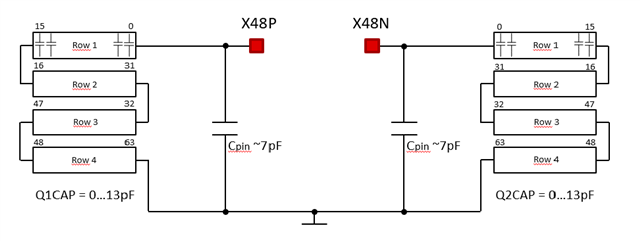

I have some questions about the Crystal tuning.

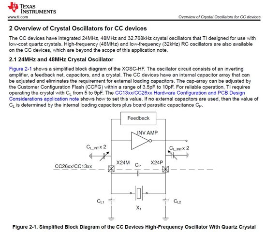

In https://www.ti.com/lit/an/swra640h/swra640h.pdf, it shows as follows.
Q1:  What is the meaning of "Cl_int x 2" for each side? Does this mean CL_int capacitor is doubled for each side?

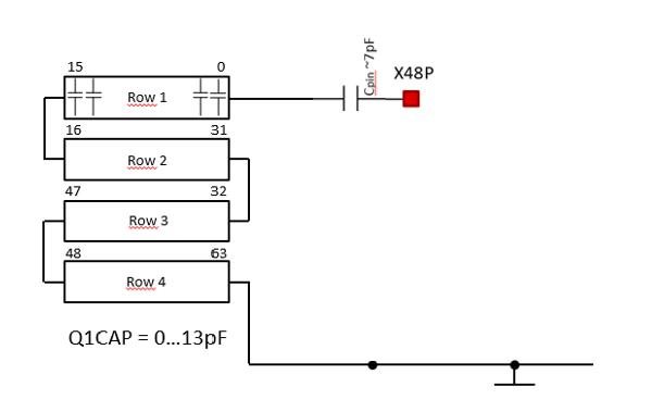

Q2.  According to the table 6.2 in  https://www.ti.com/lit/an/swra834/swra834.pdf, it described the cap array value for CC2340R5.
        Q2-1)  If I set 39 ,  which value will be set ,  7.1pF or  7.1pF x 2 ?
        Q2-2)  Can we read and confirm this setting value after setting by sysconfig ?
