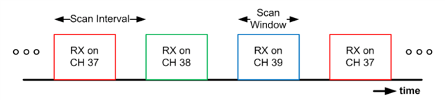

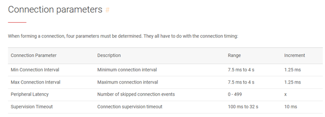

  I noticed there is a struct in the settings as shown below, and I would like to understand the functions of scanInterval and scanWindow within this struct. Furthermore, do these two parameters have any direct or indirect impacts after a Bluetooth connection is successfully established?
  I’ve observed that modifying the scan interval seems to affect the stability of the Bluetooth connection, and I’m wondering if this is a normal phenomenon.
