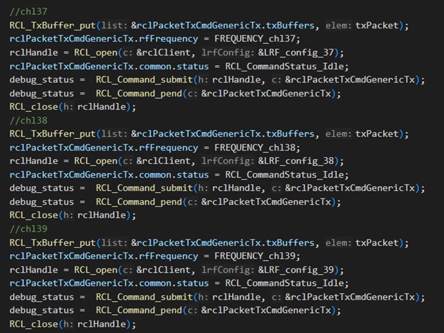

in rfPacketTx,I have successfully implemented sending data in channel 37, and can see the data in the Bluetooth sniffer. However, I tried to change the RF frequency in the code, but I cannot see the data on channels 38 and 39, and only one channel can be selected in syscfg. How do I implement this feature? I need to send data in channels 37 38 39.
I know using BLE stack can solve my problem, but we are not allowed to use practices with RTOS for this project.
    Thank you for reaching out. You should be able to change the frequency by modifying the .rfFrequency field of the RCL_CmdGenericTC structure. You will need to wait until any existing command is completed or terminate any RCL operation. The next operation submitted should use the new frequency.

  • Thank you for your answer. This is the solution I discovered yesterday. When I tried to change the frequency in cmd separately, I couldn't see the data on other channels. But I compared the differences in radio_configby switching the frequency in syscfg and found that the PBE_GENERIC_RAM.WHITEINIT in LRF_commRegCfg[] is different. So I tried updating the value when switching the frequency, and now it is working.
