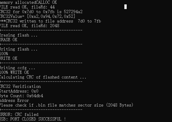

CC2340R5: 蓝牙固件通过uart串口烧录时失败
Part Number: CC2340R5
Other Parts Discussed in Thread: UNIFLASH, SYSCONFIG
When upgrading the CC2340R5 Bluetooth firmware via the serial port, the process fails during the CRC verification step, even though the flash erase and write operations were successful earlier. How should this issue be addressed?

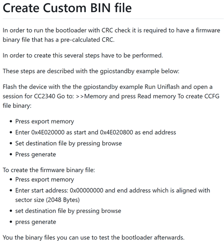

  • Hi mike,
    When using the TI_CC2340_Linux_SBL tool you have to make sure that you create a custom bin file and ensure that the firmware binary file is aligned with the sector size (0x800).  The "Byte Count" of your image (0x64db4) implies that these instructions were not adhered to.
    Ryan

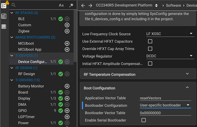

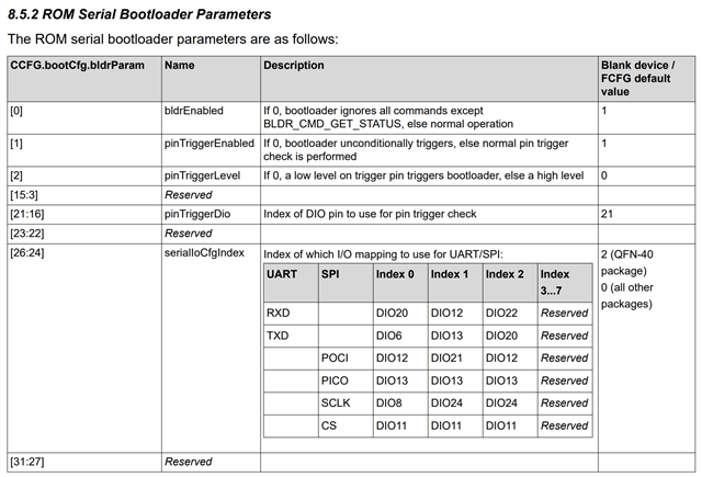

  • Could you please let me know the standard bin binary file format for the CC2340R5RGE Bluetooth firmware, or how to generate it through the memory option in the Uniflash tool? Alternatively, could you send me a copy directly? Thank you!
  • Hi, TI Engineer,
    I have sent you my host computer and CC2340R5RGE Bluetooth firmware code. Could you please help take a look? Our upgrades have been unsuccessful. The specific code is included in the attachment. Thank you!

  • Here is a screenshot from the URL I shared:
    I recommend that you use the default TI_CC2340_Linux_SBL tool provided online.  Your upgrades could very well be successful even if the CRC check fails.  You should check the changes you've made to your application before and after attempting the upgrade.  You could also choose to remove the CCFG area from your binary output generation if you do not need to apply any changes to the default CCFG settings.
    Ryan

  • 1.0x4e0207ff is the last byte of CCFG and the last byte you should be reading from Uniflash for the CCFG
    2. You should not use the .out file with the Linux SBL tool as it only accepts binaries.  You should be reading out memory in binary format from Uniflash aligned with the 0x800 sector size.  This will require programming a CC2340R5 device once with the .out file (does not have to be the ultimate target)
    4. Attached is a copy if you cannot access GitHub

  • Please be sure to read Chapter 8 (Device Boot and Bootloader) of the TRM.
    1. You likely don't mean the FCFG as this is a factory configuration which cannot be altered by users.  Upgrading via UART doesn't require a CCFG file if the default FCFG settings are being used (indicated by a blank CCFG which TI ships devices as the default).  CCFG is stored in flash and it is not recommended that users erase and write this flash during run-time as it could invalidate the CCFG if a power event or device reset occurs.
    2. The BLDR_CMD_CHIP_ERASE command invalidates and then erases CCFG, so this is possible if you are using a custom CCFG that strays from the default FCFG. will not occur unless the power failure occurs during programming of the CCFG.
    3. The ROM Serial Bootloader does not, this would require use of a custom bootloader.  You can start with MCUBoot and develop from there.
    4. This is addressed through the BLDR_CMD_CRC32 command.

  • 1. It's possible to select "User-specific bootloader" and its Bootloader Vector Table from SysConfig.  Encryption TI Drivers and examples are available for your reference, although there is no full-function custom bootloader solution currently provided by TI publicly.

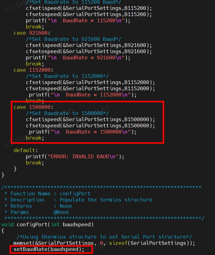

  • 1. The TI_CC2340_Linux_SBL tool supports multiple baud rate settings.  How are you changing the baud rate and have you confirmed the output TX with a logic analyzer or oscilloscope.
    2. You are looking at the SysConfig file for an example application which does not apply to the Serial ROM Bootloader functionality.
    From the TI_CC2340_Linux_SBL README:
    The Serial Boot loader is offering a prebuilt SBL.out file which can be used to run the pre-compiled image.
    In order to optimize the bootloader for your application it is possible to change the C-Code provided within the Source folder.
    The SBL consists mainly of the a set of .c and .h files:
    • Linux_Serial.c | Linux_Serial.h
    • main.c
    • myFile.c|myFile.h
    • sbl_device.c|sbl_device.h
    • sbl_device_cc2340.c|sbl_device_cc2340.h
    These files can be used to adapt the bootloader to custom applications.
    An example change is:
    Adapt baudrate: This can be done following the following steps:
    • Add the desired Baudrate to the baudSet_t enumeration in Linux_Serial.h
    • Add case in setBaudRate() function in Linux_Serial.c
    • Change setBaudRate() in configPort function
    To built the project after changing it is possible to use the makefile which is provided in the TI_CC2340_Linux_SBL folder. This can be done used by calling "make" from the Linux terminal.
    Ryan

      /*Linux_Serial.c SetBaudParm*/
      static void setBaudRate(int baud)
          switch(baud)
          case 38400:
              /*Set Baudrate to 38400 Baud*/
              cfsetispeed(&SerialPortSettings,B38400);
              cfsetospeed(&SerialPortSettings,B38400);
              printf("\n  BaudRate = 38400\n");
              break;
          case 57600:
              /*Set Baudrate to 57600 Baud*/
              cfsetispeed(&SerialPortSettings,B57600);
              cfsetospeed(&SerialPortSettings,B57600);
              printf("\n  BaudRate = 57600\n");
              break;
          case 230400:
              /*Set Baudrate to 230400 Baud*/
              cfsetispeed(&SerialPortSettings,B230400);
              cfsetospeed(&SerialPortSettings,B230400);
              printf("\n  BaudRate = 230400\n");
              break;
          case 460800:
              /*Set Baudrate to 460800 Baud*/
              cfsetispeed(&SerialPortSettings,B460800);
              cfsetospeed(&SerialPortSettings,B460800);
              printf("\n  BaudRate = 460800\n");
              break;
          case 9600:
              /*Set Baudrate to 9600 Baud*/
              cfsetispeed(&SerialPortSettings,B9600);
              cfsetospeed(&SerialPortSettings,B9600);
              printf("\n  BaudRate = 9600\n");
              break;
          case 1000000:
              /*Set Baudrate to 1000000 Baud*/
              cfsetispeed(&SerialPortSettings,B1000000);
              cfsetospeed(&SerialPortSettings,B1000000);
              printf("\n  BaudRate = 1000000\n");
              break;
          case 2000000:
              /*Set Baudrate to 2000000 Baud*/
              cfsetispeed(&SerialPortSettings,B2000000);
              cfsetospeed(&SerialPortSettings,B2000000);
              printf("\n  BaudRate = 2000000\n");
              break;
          case 115200:
              /*Set Baudrate to 115200 Baud*/
              cfsetispeed(&SerialPortSettings,B115200);
              cfsetospeed(&SerialPortSettings,B115200);
              printf("\n  BaudRate = 115200\n");
              break;
          case 921600:
              /*Set Baudrate to 921600 Baud*/
              cfsetispeed(&SerialPortSettings,B921600);
              cfsetospeed(&SerialPortSettings,B921600);
              printf("\n  BaudRate = 921600\n");
              break;
          case 1152000:
              /*Set Baudrate to 1152000*/
              cfsetispeed(&SerialPortSettings,B1152000);
              cfsetospeed(&SerialPortSettings,B1152000);
               printf("\n  BaudRate = 1152000\n");
              break;
          case 1500000:
              /*Set Baudrate to 1500000*/
              cfsetispeed(&SerialPortSettings,B1500000);
              cfsetospeed(&SerialPortSettings,B1500000);
               printf("\n  BaudRate = 1500000\n");
              break;
          default:
              printf("ERROR: INVALID BAUD\n");
              break;
       * Function Name : configPort
       * Description   : Populate the termios structure
       * Returns       : None
       * Params        @None
      void configPort(int baudspeed)
           /*Using thermios structure to set Serial Port structure*/
          memset(&SerialPortSettings, 0, sizeof(SerialPortSettings));
          setBaudRate(baudspeed);
          /*Configure serial port message interpretation */
          /* Enable receiver*/
          SerialPortSettings.c_cflag |= (CLOCAL | CREAD);
          /* Set Data Size= 8Bit        */
          SerialPortSettings.c_cflag &= ~CSIZE;
          SerialPortSettings.c_cflag |= CS8;
          /* No Parity   */
          SerialPortSettings.c_cflag &= ~PARENB;
          /* 1 Stop bit */
          SerialPortSettings.c_cflag &= ~CSTOPB;
          SerialPortSettings.c_cflag &= ~CRTSCTS;
          /* setup for non-canonical mode */
          SerialPortSettings.c_iflag &= ~(IGNBRK | BRKINT | PARMRK | ISTRIP | INLCR | IGNCR | ICRNL | IXON);
          SerialPortSettings.c_lflag &= ~(ECHO | ECHONL | ICANON | ISIG | IEXTEN);
          SerialPortSettings.c_oflag &= ~OPOST;
          /* fetch bytes as they become available */
          SerialPortSettings.c_cc[VMIN] = 0;
          SerialPortSettings.c_cc[VTIME] = 2;
          /* Flush out if there is any previously pending shit* */
          clearRxbuffer();
          if((tcsetattr(fd,TCSANOW,&SerialPortSettings)) != 0)
              perror("ERROR in Setting attributes |");
          else
              printf("  StopBits = 1 \n  Parity   = none\n");
    1. Our times are very similar, mine was only reduced further after modifying the sbl_device_cc2340.c file of the default example as provided from GitHub.
    2. The code sources appear similar.  Did you make sure to re-build the tool after saving changes?  You should no longer see the flash write procedure updating from 0 to 100%, but it will still be progressing in the background.
    3. I believe other forms of communication would provide no further benefit to the resolution of this investigation.
    Ryan
