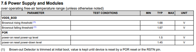

Hi Forum,
How to config brownout threshold value? could you please provide an base code

Hi Vaibhav,
The BOD threshold is not configurable and it's values are stated in the Datasheet.
