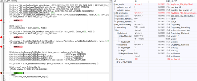

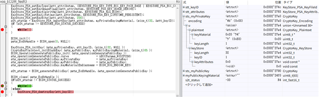

I'm trying to generate a public key from a private key stored in PSA storage,
but the value of s2t_status upon completion of ECDH_generatePublicKey() is -33.
How can I resolve this?

    It appears that you are mixing a wide variety of APIs. If you are using PSA, you can only use PSA and not the SimpleLink APIs. They are not compatible. I suggest using the PSA APIs. Here is an example using the PSA API.

    I would like to achieve this function using only the SimpleLink API. Is this possible?
    When I ran it with the modified source, the value of s2t_status remained -33 when ECDH_generatePublicKey() completed.

    If you are going to use the SimpleLink APIs, then you can't use PSA or Keystore. I'd suggest moving to PSA since the PSA driver is a wrapper around the SimpleLink drivers. Additionally, SimpleLink crypto drivers will be deprecated in the future.
