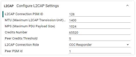

CC2745R10-Q1: L2CAP Credit Based PSM range in syscfg tool
Part Number: CC2745R10-Q1
Why does syscfg tool not allow setting L2CAP Credit Based PSM to 0x0080 (128)
According to https://www.bluetooth.com/wp-content/uploads/Files/Specification/HTML/Core-54/out/en/host/logical-link-control-and-adaptation-protocol-specification.html#UUID-a4938738-b892-d188-e381-ca2eb72b586b
then range is:
/Brian
