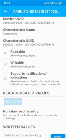

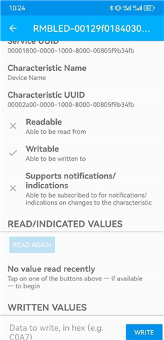

I find that the CHAR Device Name and Appearance are only writable, and also I ran the example project simple_peripheral, the result is the same, how can I enable the readable property?
The project use  GGS_SetParameter(GGS_DEVICE_NAME_ATT, GAP_DEVICE_NAME_LEN, attDeviceName) to set device name. It seems that SDK set the property to writable.

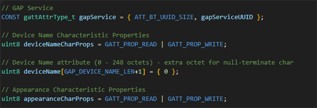

    Thank you for reaching out! This is a really good question! To modify the properties of the characteristics, you will have to go to the gapgattserver.c file located in the sdk at the following location: source/ti/ble5stack/host, and modify the gatt table to reflect what you want it to do.
