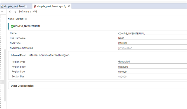

Hello, I am in the following project. C:\ti\simplelink_cc13xx_cc26xx_sdk_7_10_01_24\examples\rtos\CC26X2R1_LAUNCHXL\ble5stack\simple_peripheral。 We have developed our application. We will complete the pairing of jutwork with the mobile app. The NVS configuration of our program is as follows:
Then my new version was developed in the following project: C:\ti\simplelink_cc13xx_cc26xx_sdk_7_41_00_17\examples\rtos\CC26X2R1_LAUNCHXL\ble5stack\simple_peripheral

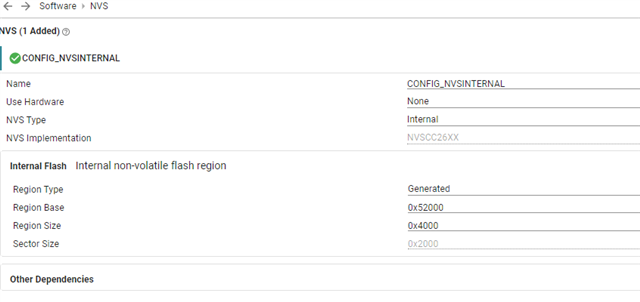

The NVS area configuration is as follows:
After completing the pairing and binding under the 0710 SDK version, I upgraded to the 0741 SDK version without erasing and downloading NVS and ccfg. However, the encrypted connection could not be completed, and my phone would prompt that the car pairing information was lost.
The following image is a comparison of the NVS readings before and after I upgraded the 0741 SDK version of the program
On the left is the NVS area before upgrading the 0741 SDK, and on the right is the NVS area after upgrading the 0741 SDK

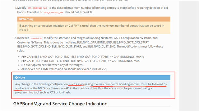

    3、I saw the following description in your official link:
    https://dev.ti.com/tirex/content/simplelink_cc13xx_cc26xx_sdk_7_10_01_24/docs/ble5stack/ble_user_guide/html/ble-stack-5.x/gapbondmngr-cc13xx_cc26xx.html#gapbondmgr-examples-for-manipulating-bonding
    My maximum binding quantity in SDK 0710 is 10, and in SDK 0741 it is 30. According to the instructions on your official website, if I want to upgrade, I must
    Wipe off NV.
    Now that the MAC address type has changed, your SDK has deleted the binding information. In this case, do I still need to do a complete erasure of NV?
    If Address type changed, the device will be identified as a different device. So old bond information does not work for "new" device, which is a normal behavior.
    If increase the number of bonding records,  a full NV erase is "must" operation.
    BR.
  • hi
    Your Answer   " If increase the number of bonding records, a full NV erase is "must" operation."
    What is the reason for having to do this? Can you please explain to me, and what problems may exist if all NV erasures are not done?
  • Because each bonding information will need to write into NV. Changing the GAP_BONDINGS_MAX means different amount of NV entries in maximum. The old information stored in NV may have conflicts to the information need to store under newer configuration. Which will cause abnormal behavior during encryption process.
