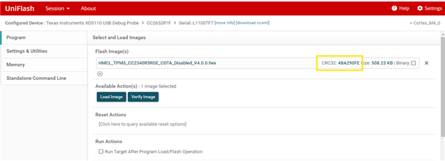

Is there a command line tool command to get a hex file checksum, which we get in Uniflash when we browse the file

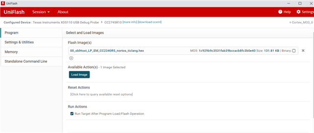

Got it. On my end, it is showing MD5 instead (using version Uniflash version 9.2.0.5300).
Which version of Uniflash are you using?

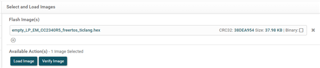

Can you try opening an .hex file generated from an out-of-box SDK example?
I've uploaded one here for reference: https://e2e.ti.com/cfs-file/__key/communityserver-discussions-components-files/538/empty_5F00_LP_5F00_EM_5F00_CC2340R5_5F00_freertos_5F00_ticlang.hex
