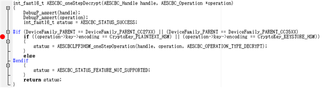

Looking at the SDK source, it only processes key encodings CryptoKey_PLAINTEXT_HSM or CryptoKey_KEYSTORE_HSM.
Does this mean that CBC decryption is not possible unless the key is stored on an HSM?
Is it possible to perform CBC decryption using a key stored in PSA storage (with a lifetime of KEYSTORE_PSA_KEY_LIFETIME_PERSISTENT)?
Also, could you tell me how to enable ENABLE_KEY_STORAGE (a SysConfig setting?)?
※If the key encoding is CryptoKey_KEYSTORE_HSM, ENABLE_KEY_STORAGE must be enabled in the compilation software.

    When I debugged it, I found that ENABLE_KEY_STORAGE was disabled, so the error message AESCBC_STATUS_FEATURE_NOT_SUPPORTED was displayed and the code terminated.
    Please tell me how to resolve this.
