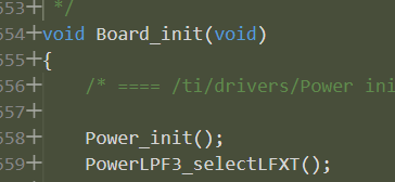

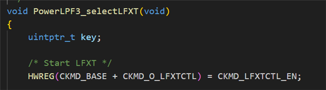

  • Hi !
    SysConfig generates a file named ti_driver_config.c. In this file, the function Board_init calls "PowerLPF3_selectLFXT".
    This function enables the LFXT by writing to the LFCLKSEL register
    Can you check if this function is correctly called in your Board_init function and if it correctly sets the register ?

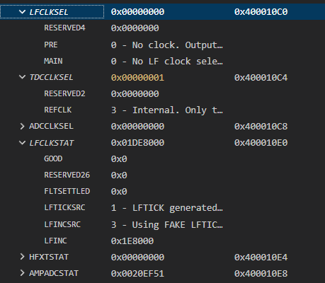

    If my understanding is correct. The PowerLPF3_selectLFXT() set the EN bit of LFXTCTL (and yes, the EN bit is 1), the it start a TDC measurement process, it seems to detect if the LFXT works as expect. After the measurement successed, it will set the LFCKSEL for LFXT.
    When the HFXT crystal exists, it works. But when the HFXT crystal has been removed, the TDC measurement seems finished (IMASK.TDCDONE is 1), but LFCKSEL did not changed. Also, all GOOD bit for LFXT registers does not turn to 1.
    That's why I wonder if it would affect the detection process of LFXT if HFXT didn't exist.

    From what I can read in the C:\ti\simplelink_lowpower_f3_sdk_9_11_00_18\source\ti\drivers\power\PowerCC23X0.c file, the LFXT clock uses the HFXT for calibration by running TDC measurements. If the HFXT is absent, the measurements will be absent or incorrect, and the LFXT initialization will fail.
    What you could try to do is to change the ti_drivers_config.c file to skip the TDC measurement and to directly enable and select the LFXT as the LFCLK. This is done in the PowerCC23X0_lfoscQual function through the HWREG(CKMD_BASE + CKMD_O_LFCLKSEL) = CKMD_LFCLKSEL_PRE_LFOSC | CKMD_LFCLKSEL_MAIN_LFOSC; line. In any case, your LFXT will be less accurate, since it will not be qualified.
