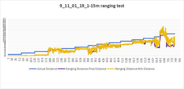

During fixed-point testing at 1-15 meters with the new SDK (9_11_01_19) (60 range measurements per meter interval using Python scripts), we observed significantly larger fluctuations in distance values at fixed points compared to previous versions (9_11_00_18, 9_11_01_09, 9_12_00_19). Are you experiencing similar issues on your end?
The figure below shows the staircase plot we generated (SDK_9_11_01_19):
I've attached the current code and scripts I'm using, along with the fixed-point test logs. After switching to the NN algorithm, are there any parameters that need adjustment? Since we previously tested exclusively with the MUSIC algorithm.

Hello Preston,
Understand the concern and frustration. The team is still developing the algorithms and are considering the next steps in algorithm development.
The neural network in the current SDK is trained for the inside of a vehicle. Please try this to see better results. Additionally, thank you for the feedback on the algorithm.

Hello Preston,
The initiator will be placed inside the vehicle, in the center console. Neural networks are "trained" on phase data collected from a specific environment. The current SDK neural network is trained from the center console of a vehicle.
