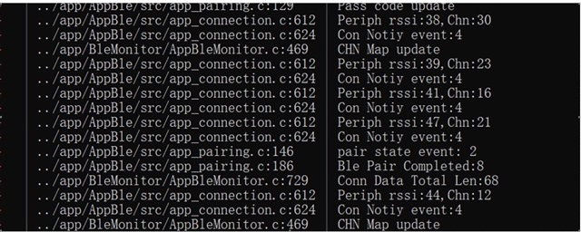

CC2745R10-Q1: CC2745R10-Q1 EVM pair with mobile phone and then reflash EVM. After that, the mobile phone reconnect to EVM and pairing will fail
Part Number: CC2745R10-Q1
HW: TI CC2745R10-Q1 EVM (car node) and a mobile phone
SW: SDK 9.11.01.19
The car_node project default pairing code is123456, and the pairing mode is: Initiate a pairing request.
How to reproduce:
The TI CC2745R10-Q1 EVM complete pairing binding with mobile phone for the first time, and reflash TI CC2745R10-Q1 EVM, at this moment, the passkey is lost. (This is under expectation since we didn't protect flash)
Then the mobile phone reconnects to the TI CC2745R10-Q1 EVM and a pop-up prompt to enter the passkey will appear. The passkey is also entered as 123456, the status of the TI CC2745R10-Q1 EVM pairing completion prompt is not successful and the return value is 0x08.
Please help how to solve this issue if the phone does not actively clear the passkey
The log is like below:
