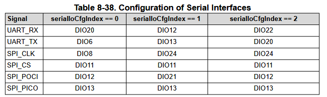

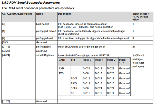

We have designed our BLE module using the CC2340R53N0RKPR (64KB variant) chipset and recently received the samples. In our design, we have selected the following default bootloader UART pins:
  • TXD: DIO20_A11
  • RXD: DIO22_A9
Could you please confirm if the selected I/Os are correct? Client wants serial bootloader functionality for firmware update process - for blank IC's & for Already flashed IC's (*With valid CCFG).
Looking forward to your confirmation.
