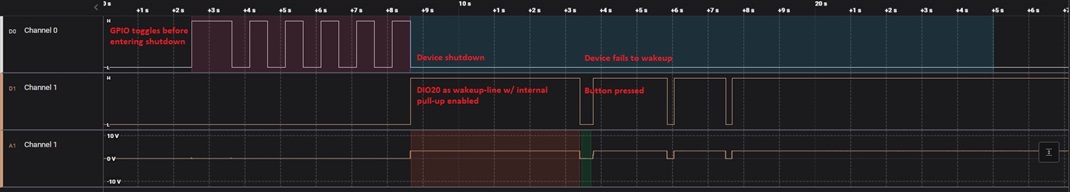

This is where I have a problem with wakeup from shutdown. Earlier I did not have lines #65 and #66, but added recently.
  • With lines #64, #65 & #66 all enabled, device wakes up only from CONFIG_GPIO_SPI_PERIPHERAL_CSN pin.
  • With #64 commented, #65 & #66 enabled, device wakes up with other two pins (CONFIG_GPIO_BTN1 and CONFIG_GPIO_BTN2).
  • With #65 & #66 commented, #64 enabled, device still wakes up.
Please find the saleae captures attached here for your reference.

  • Followup information:
    MCU: CC2340R5-RGE with our custom PCB
    DIO11: SPI chip select
    DIO8: Button1 /w internal pull-up
    DIO20: Button 2 /w internal pull-up

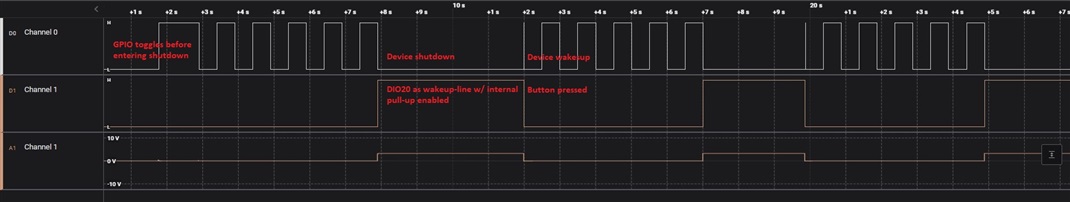

  • Hi Alex,
    Thanks for your prompt response.
    There's one difference with the test I did earlier. The SPI-CS line was left un-connected. However, on custom PCB this line is connected to the SPI Controller (master, RF432). On the SPI Controller side the chip-select line gets switched to GPIO output mode with High state and on CC2340 it is switched to GPIO input mode with internal pull-up for achieving least power consumption.
    Jaimin

    I probed the chip-select line today and took a quick capture with logic analyzer.
    I see that the chip-select is held low after power-on-reset.
    Please find the link below for the capture file.
    /cfs-file/__key/communityserver-discussions-components-files/538/cs_5F00_probed.zip
    Jaimin

  • Hi Alex,
    The chip select pin is in active low configuration.
    The cropped area of the image is my concern. You can see that button press detection is not waking up the device if the chip select is low, I am expecting it to wakeup. This is an issue that has to be investigated by TI from your earlier reply.
    Why the chip select is low after reset?
    The cropped area shows a case when both the MCUs are in IDLE state and go to low power mode due to inactivity. The other MCU, which is an SPI Controller (master), the chip select line is not hardware controlled by the SPI but is a GPIO controlled. So, after reset this MCU initializes SPI driver but the chip select remains low. Only during an SPI transfer the chip select line is controlled in Active Low manner. This MCU remains in IDLE state for some amount of time and enters low power mode if there's no activity, which explains the chip select low in your cropped area. If there's an acitivty it does an SPI transfer causing chip select to go momentarily go high, then low during the transfer and continues to reman high. Then enters low power mode again.
    I hope this answers your question?

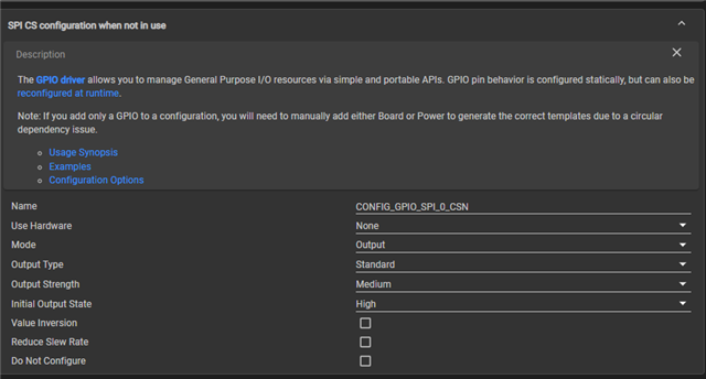

    As workaround, during the initialization phase I made chip select high on the SPI Controller to see if cc2340 wakes up from buttons. It did wakeup, we already know the reason. I will have to test it thoroughly before accepting this as the solution.
    Please note that the other MCU has NDA, I am willing to share the code directly with you or via business e2e support if that's possible.
    Jaimin
    From our earlier observations this does seem like one of the paths we could take here. Forcing the CS high manually to allow us to have control.
    Alex F
