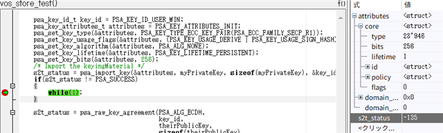

In the test code below,
the algorithm is not specified when importing the key:
psa_set_key_algorithm(&attributes, PSA_ALG_NONE);
I would like to specify the algorithm only at the time of use,
psa_raw_key_agreement(PSA_ALG_ECDH, key_id, ‥
psa_sign_hash(key_id, PSA_ALG_ECDSA(PSA_ALG_SHA_256), ‥
This did not work (psa_import_key returned error code -135).

    psa_key_id_t key_id = PSA_KEY_ID_USER_MIN;
    psa_key_attributes_t attributes = PSA_KEY_ATTRIBUTES_INIT;
    psa_set_key_type(&attributes, PSA_KEY_TYPE_ECC_KEY_PAIR(PSA_ECC_FAMILY_SECP_R1));
    psa_set_key_usage_flags(&attributes, (PSA_KEY_USAGE_DERIVE | PSA_KEY_USAGE_SIGN_HASH));
    psa_set_key_lifetime(&attributes, PSA_KEY_LIFETIME_PERSISTENT);
    psa_set_key_bits(&attributes, 256);
    /* Import the keyingMaterial */
    s2t_status = psa_import_key(&attributes, myPrivateKey, sizeof(myPrivateKey), &key_id);
    if(s2t_status != PSA_SUCCESS)
        while(1);

    I'm considering using the same key for multiple functions.
    When I did a test before with AES crypto I was able to re-use the key on different plaintexts.
    Alex F
    I've been able to import the key twice (ECDH, ECDSA) and use psa_raw_key_agreement and psa_sign_hash,
    but I'm looking for a way to import the key once and use both psa_raw_key_agreement and psa_sign_hash.
    Is this possible? If so, please tell me how.
    Just so I am not misunderstanding your question, you want to call psa_import_key(...) once and then use it for both ECDH and ECDSA? Or are you using some other function currently.
    Alex F
  • yes, I want to call psa_import_key(...) once and then use it for both ECDH and ECDSA?
    After looking into it some more if we are specifically using the psa_import_key(...) function we cannot re-use the key/call. The reason being is that the psa_import_key function calls the psa_key_attributes which each ECDH and ECDSA have their own specific attributes; so once we call psa_import_key for ECDH or ECDSA we cannot use it for the other algorithm.
    This is the correct path for using the psa_import_key(...) function.
