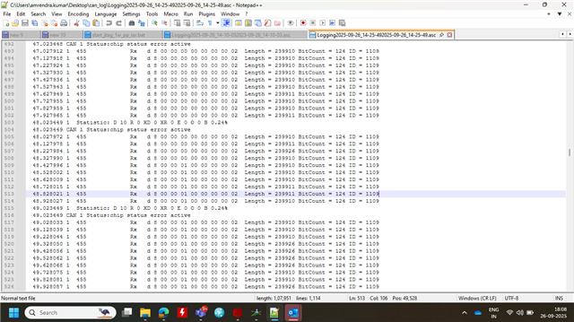

    i have attached can logs for the same, you can see there.
for e.g-    0.488845 1 455             Rx   d 8 01 0E 01 00 00 00 00 00 (this is for example)
455 – this is CAN id.
8 – DLC
first byte 01- distance in meter.
second byte 04-distance in cm.
Third byte 01 – connection status (0 -not connected/ 1 - connected).
All these data are in hex format.
 In this case it is connected with providing distance of – 1m 14 cm.
