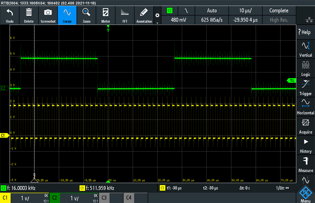

I am using a TI CC2564MODNEM Bluetooth controller and an STM32F401 microcontroller. I would like the CC256 to provide a PCM/I2S audio interface in slave mode, with the STM32 acting as the bus master and providing the bit clock and LR clock. The application is a Bluetooth HFP demo.
On startup, the nSHUTDOWN_1V8 pin on the CC256 is set low for 250 ms, then set high (the program waits for an additional 500 ms before continuing). After this, the STM32 sends the CC256 its init script version 1.8 from the CC256XB Bluetooth Service Pack from TI (https://www.ti.com/tool/CC256XB-BT-SP). Specifically, I am using initscripts-TIInit_6.7.16_bt_spec_4.1.bts and initscripts-TIInit_6.7.16_ble_add-on.bts.
Next, the CC256 should be configured for I2S in slave mode. To do this, I am using the HCI_VS_Write_CODEC_Config command, 0xFD06. I am referencing the vendor-specific HCI commands for the CC256 here: https://www.ti.com/lit/an/swra751/swra751.pdf. I will omit the full source code for my STM32 program, but just to get an idea, my array of data for the HCI_VS_Write_CODEC_Config command looks like this:

Note that PCM clock direction is set to 0x01, which means "PCM clock and Fsync direction is input" according to the TI VS HCI command documentation. The HCI packet dump from the device initialization shows that this command is being sent by the STM32 and processed by the CC256. The snippet from the packet dump below shows a Command Complete event (0E) for the command 06 FD (little endian) with a return code of 00 (success).
[00:00:05.403] CMD => 06 FD 22 00 01 01 40 1F 00 00 00 00 01 01 00 10 00 00 00 01 10 00 00 00 01 00 10 00 10 00 00 10 00 10 00 00 00
[00:00:05.421] EVT <= 0E 04 01 06 FD 00
However, when I connect my phone to the CC256 via Bluetooth and make a phone call to get HFP data going, the CC256 appears to be driving the AUD_FSYNC_1V8 and AUD_CLK_1V8 pins, as shown in the oscilloscope capture below. The green trace (top) is the LR clock (AUD_FSYNC_1V8) and yellow is the bit clock (AUD_CLK_1V8). These signals are disconnected from the STM32 and connected only to the CC256 and the scope probes. I would have expected the CC256 not to drive these clock signals and instead to accept them as inputs, given my configuration for the PCM clock direction above. What am I missing here? How can I configure the CC256 for I2S in slave mode?
I have attached the full HCI packet dump from initialization (cc256-hci-packet-dump.txt).
