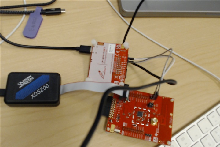

I wanted to use the XDS 220 ISO I have, from Spectrum Digital, on this chip, but have no luck connecting to it.
I'm using the 10-pin connector on the board.
Error I get is SC_ERR_SWD_PROTOCOL, with log below

I tried lowering debugger clock rate to 1Mhz, with no luck.

    I was able connect to my LP-EM-CC2745R10-Q1 with a Spectrum Digital XDS220 using the 10-pin header on the board via a 20-to-10 pin adapter.
    The JTAG connectivity test via "Test Connections" button passes:
    Check your adapter/connections, make sure they are all good.
    ki
  • I can do a test connection ok.
    I have a regular XDS200 vs the 220.  I am connected via a cTI20 to cortex10 adapter.  I am powering the LaunchPad via the 3.3V and GND pins on the spit XDS110.

    I can then launch a debug session in CCS and connect to the M33.  However when I try to load one of my programs to flash I get an error.  A couple of us are experimenting with this and will provide more info tomorrow.
    The XDS110 would be the default debug probe used with this device and it also has a secure debug manager which I am not sure if we support that with XDS200.

  • More example /details:
    Board not powered log, so it senses something is on/off wire...
    But now i have tried 2 different power supply modes - one from same laptop USB, to 3.3v converter to jumper wires, and one external PSU, but even though board is powered , green led is on, all I get is SC_ERR_SWD_PROTOCOL. No luck ...
  •   Can you then show your physical setup, with a pic or two? Including how you powering the board.
    Also, what is your EVM revision number? of the launchpad
  • The XDS110 would be the default debug probe used with this device and it also has a secure debug manager which I am not sure if we support that with XDS200.
    Unfortunately this appears to be the case. It only appears supported with XDS110.
    Hence we cannot recommend a non-XDS110 debug probe (for this device).
  • Given the lack of XDS200 support for this device the cheapest option ($29) would be to get a https://www.ti.com/tool/LP-XDS110
    It is a stripped down XDS110 that can connect to the LaunchPad you are using.  It also comes with a 10pin cable for connecting to custom boards that have the Cortex 10 header on them and you can power board from it.  I was actually using it to power the board when I was testing my XDS200 connection.

  • Currently it is the CC234x and CC27x5 devices that have the feature that is not supported by anything other than XDS110.
    John
