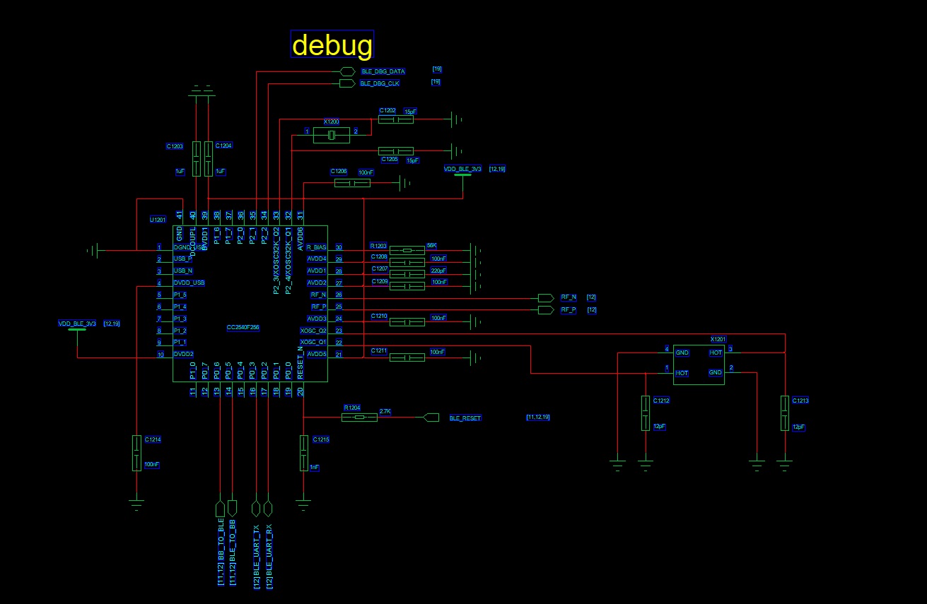

The customer is currently using TI's CC2540 for their tracker project and has encountered the following issues while scanning in master mode,
The customer's original question is as follows:
1.In our office environment (with over 100 Bluetooth devices around), I often encounter CCU being unable to scan and report beacon information within 15 seconds,
even if the beacon pin is right next to the CCU.
In environments with high levels of Bluetooth, there may be situations where the target device cannot be scanned for a long time, and even if it is very close, it is often not scanned within 15 seconds.
The schematic diagram is as follows:
The test data is as follows:

  • Hello Jimmy,
    Thanks for reaching out.
    In crowded BLE RF environments it is usual to see increased time to detect a specific device advertising. Do you have information about the beacon (broadcaster), what is the TX power, advertisement interval, etc?
    BR,
    David.
  • Hello David:
    1. The AD interval for the beacon pin is 500ms
    2. At present, the customer has provided a level and coverage area for Tx power, but specific parameters cannot be provided yet and are still being confirmed.
    Transmission power level
    In most scenarios, the transmission power can be selected as the default level 3.In special cases, it is necessary to appropriately scale the level of transmission power according to experience.For example, the parking range is relatively large, and it is acceptable for the vehicle to park in the scene of more than 4 times the area of the original parking area around the parking area. At this time, it can be considered to increase the transmission power level by 1 ~ 2 levels.
    Typical radius when set to different transmission power level:
    1-0.6m
    2-1.5m
    3-2m
    4-3m
    5-5m
     Note: The above is a typical value. In fact, which is not so accurate in practice.
  • Hello Jimmy,
    Some considerations:
    1. Slow advertising: higher advertising interval, lower power consumption, low probability of short discovery time
    2. Fast advertising: lower advertising interval, higher power consumption, high probability of short discovery time.
    3. In a time-constrained application, when the user needs to receive the data as fast as possible, make sure that scanning window is more than the advertising interval + 10ms to guarantee discovery. (The 10 ms extra account for the 0 ms to 10 ms of pseudo-random delay in between each advertising event, assuming no interference.)
    4. Directed Advertising: For rapid re-connection with a specific known device, use directed advertising, which can use low advertising intervals.
    5. Continuous Scanning: If you need to find devices continuously, you might set the scan duration to an indefinite value. Be aware that this may impact battery life.
    BR,
    David.
