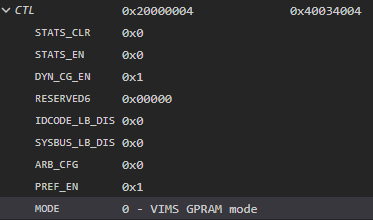

  • Hello Kaiwalya,
    I think the issue I am seeing is hinting to the mem space of the GPRAM still being used as cache and it is a matter of disabling that functionality correctly. For instance, if I run the program without repurposing to GPRAM, and therefore having the application running correctly, I see that the memory space (where the GPRAM points to) is getting the same values (through NVS calls - FLASH reads) as the ones that are overwriting the stack and causing the issue in our case. This is happening in osal_init_system() right before calling osal_start_system() (both inside osal_icall_ble.c) where the evaluation of the "stack overflow" I mentioned before is happening.
    GPRAM Mem Space (no repurposing)
    GPRAM Mem Space (repurposing)
    I will update you soon.

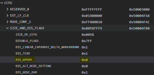

  • Hello Kaiwalya,
    I have found that the GPRAM space is used as part of the compaction mechanism of the NV. You can search for NVOCMP_GPRAM inside nvocmp.c where you can see that the GPRAM_BASE is assigned to a local buffer for compaction purposes inside NVOCMP_compact(). By disabling NVOCMP_GPRAM, the GPRAM memory space is available to be used and therefore the stack is not overwritten. However this ends up in a ICall_abort() I am currently working on figuring out.
    BR,
    David.
