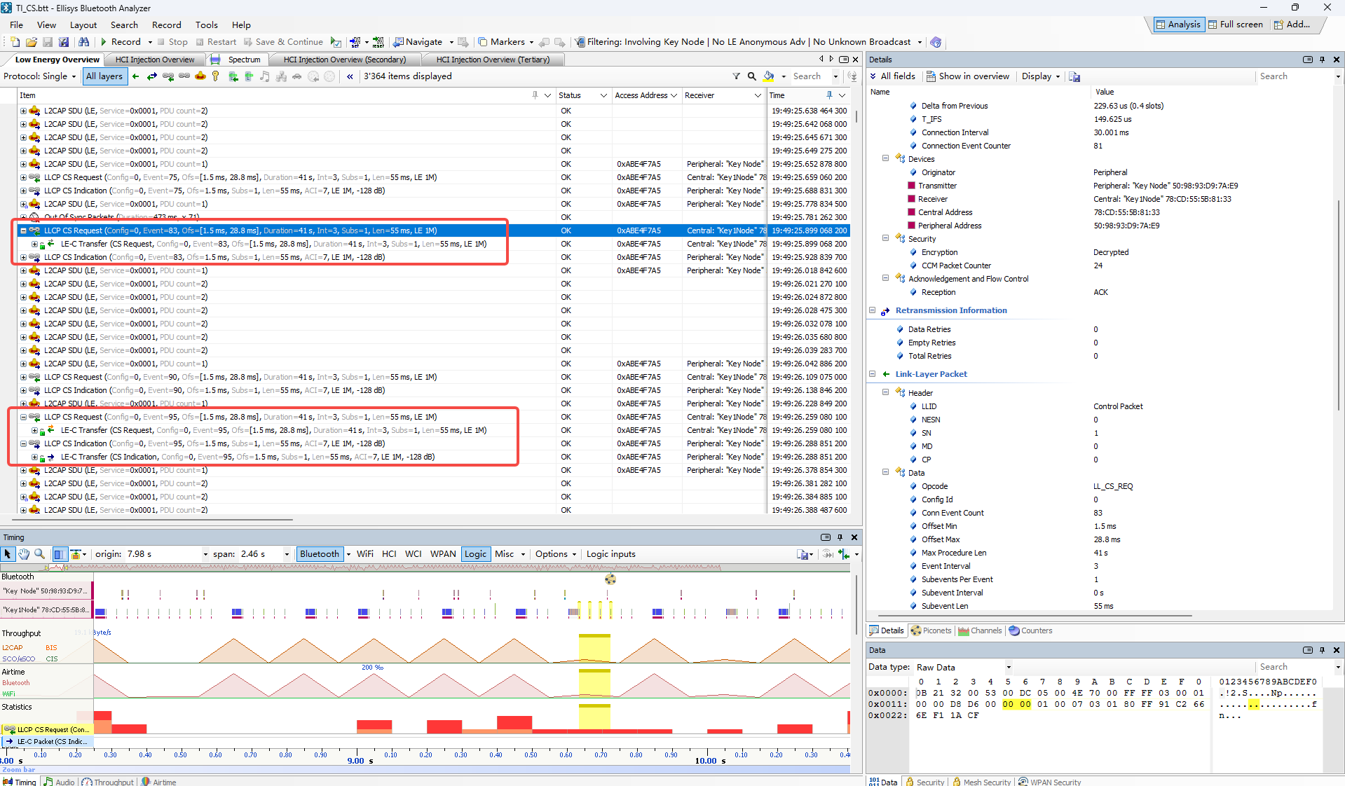

2. When I capture the sniffer log, the carnode, acting as the Reflector, requests to start CS and sends an LL_CS_Request. The keynode, acting as the Initor, does not return an LLCP_CS_Response packet to the Reflector. I believe this is a problem.screenshot-20251029-142326.png

    2. To clarify, the key node is the central initiator, and the car node is the peripheral reflector? If this is the case, then channel sounding is operating as expected. The if the Central node of the connection receives either a CS REQ LLCP or a CS RSP LLCP, then the central will respond with a CS IND LLCP. See Bluetooth LE Version 6 Specification in section Vol 6, Part B, Section 5.1.26.
