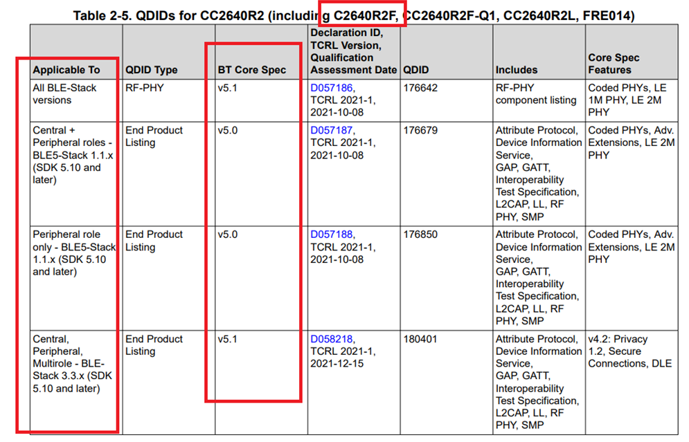

Hello Vasu,
You can see both in the Release Notes: software-dl.ti.com/.../Documentation_Overview.html
Two Bluetooth qualified protocol stack components are included, one for developing with advanced Bluetooth 5 (BLE5-Stack) featured, and one for memory-optimized Bluetooth 5.1 applications (BLE-Stack), using features defined by the Bluetooth 4.2 specification. This is also stated in the app note, please see what core features are included (left side column).

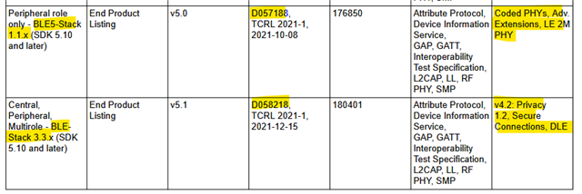

Inside the SDK:
Hope this helps.
