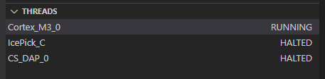

  • Hello Nico,
    this view shows that I am somehow able to connect to the DAP.
    Correct, this seems like you can at least enter a debug session, as a double check can you open UniFlash and attempt to read the memory or see if you can manually completely erase the device?
    both of my two working prototypes of different design iterations "broke" at the same time, so I suspected that it is a fault that somehow might have to do with the launchpad used for programming or the CCS IDE.

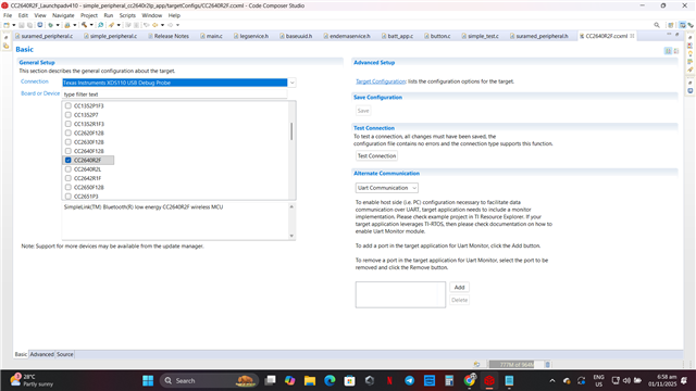

    The XDS is what programs the board, not the LaunchPad itself; what did you set your device permission settings in Sysconfig to?
    Seeing as both of the board "broke at the same time" did you program the same image to both, or were these two completely separate images?
    Again lets try to see if the UniFlash tool can first connect to the device, then do a full mass erase of the device and try to re-flash it to see it starts working again.
    Alexander F
    See, Cannot access the DAP Error -1170 from the link below. This is usually caused by either a hardware failure on the board or invalid code on the subcore that causes it to reset itself continuously..
    https://software-dl.ti.com/ccs/esd/documents/ccs_debugging_jtag_connectivity_issues.html#cannot-access-the-dap
    This should be not a problem if you use one of the example programs in the SDK as base for your program.
    Also make sure the target board is set to CC2640R2F.
    -kel
