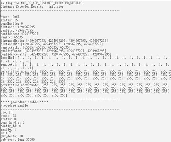

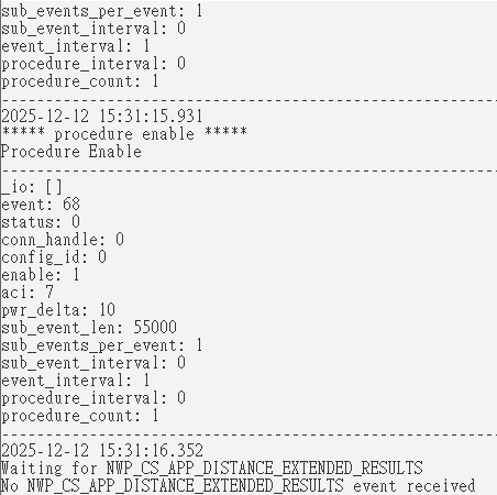

We used CC2745R10-Q1 as CarNode and CC2340R53 as KeyNode to test CS in Python demo, but the distance value could not be obtained.How to implement CC2745R10-Q1 and CC2340R53 channel sounding ranging on SDK9.14.10.41? How to set the parameters of channel sounding and ranging? Is the following configuration correct? thank you
Result:
mode 2 no distance:
mode 3 no distance:

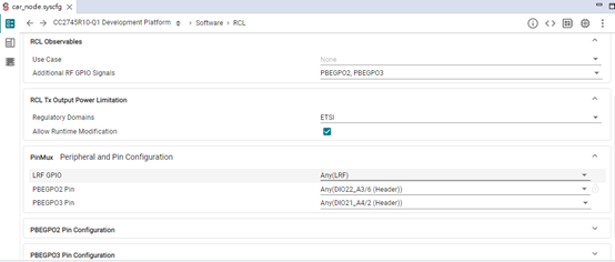

    First, what is the preferred_peer_antenna variable within the procedure parameters set to? If you are using 2x2 antenna configuration, you should set this to 0b0011.
    Second, are you using a CC2340R53 LaunchPad? If you are, the RCL PBEGPO2, and PBEGPO3 PinMux need to be configured differently. These should be set to DIO7 for PBEGPO2, and DIO21 PBEGPO3.
    Let me know if this helps.
    Isaac
  • Hi, Isaac:
    Thank you for your prompt reply.
    1.Yes, I am using dual antennas, and the preferred_peer_antenna parameter is also set to 0b0011.
    2.Yes, we are using the CC2340R53 LaunchPad. I have configured the pin PBEGPO2 as DIO7, and the pin PBEGPO3 as DIO21.
    After testing, we still have not obtained the ranging data of channel sounding.May I ask if your test data is all normal? Could you provide the parameters of your CC2340R53 for our reference?

  • Hello Burt,

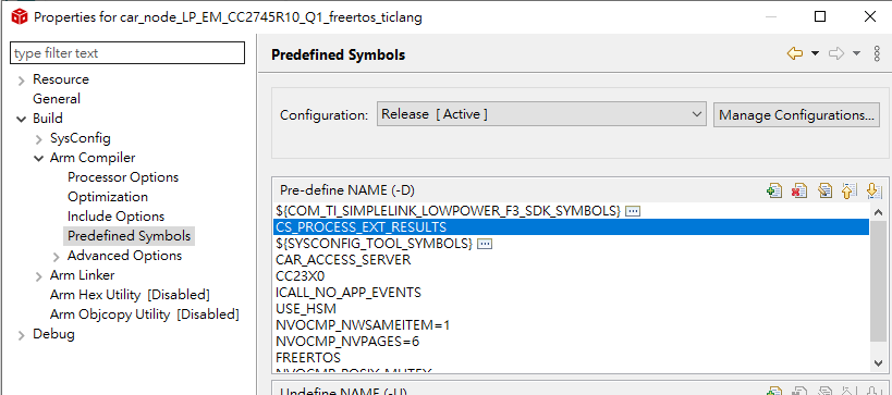

    No this is not normal. I have tested the CC2745R10-Q1 Initiator/Central/RAS Client, to a CC2340R53-Q1 Reflector/Peripheral/RAS Server before and observed distance results. Additionally, I have tested with L2CAP instead of RAS with the same results.
    Can you try running the demo without extended debug results? I have not tested that but will do so tomorrow to see if I observe the same output as you.
    Isaac
  • Hi, Isaac:
    I have completed testing in single-antenna mode without extended debug results, where the CC2745R10-Q1 was configured as an Initiator/Central/RAS Client paired with a CC2340R53-Q1 configured as a Reflector/Peripheral/RAS Server—and reliable distance results were successfully observed.
    I then attempted testing in dual-antenna mode(also without extended debug results). I configured the Antenna Mux Bitmap to 0xC6, assigned pin PBEGPO2 to DIO7 and pin PBEGPO3 to DIO21, and set the preferred_peer_antenna parameter to 0b0011 &aci:7.However, I have been unable to observe  distance results under this dual-antenna setup.
    When you testing the dual-antenna ranging function of CC2745R10-Q1 and CC2340R53, is it possible to measure the distance normally? Is the distance value obtained through ranging normal?
    The following is the log of my test:

    Distance Results - initiator
    _io: []
    event: 96
    status: 0
    connHandle: 0
    distance: 10
    quality: 1710
    confidence: 100
    Example ended

  • Hello  Isaac,
    I have disabled the ranging server of cc2340r53 and the ranging client of cc2745r10-q1 through Syscfg. Can this setting be regarded as using L2CAP transmission?
    Based on the above settings, enabling the dual antennas of CC2340R53 and CC2745R10-Q1 results in no distance data output.

  • Hello Burt,
    I will summarize your findings below:
    1. Using CC27xx as initiator/central/RAS client w/ extended debug results shows invalid outputs with 2x2 antenna configuration.
    2. With the same configuration, but w/o extended debug results and 1x1 antenna configuration you observe valid distance output.
    3. Using L2CAP with 2x2 you observe no extended debug outputs. Do you also not observe regular distance outputs?
    I am back in the office after the holidays and was able to test CS with CC27xx Init/Central/Ras Client, and CC2340R53 Ref/Peripheral/Ras Server, and observed the problem. I see a distance output maybe 5% of the time. I am doing some more debugging and will update the team with the problem.
    Isaac
