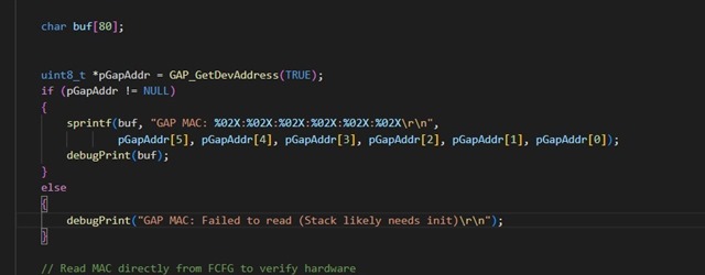

  • I Have uploaded images of the same program in both the Custom Board & Dev Board , with the code snippet below
    I have enabled Public address in Sysconfig and yet a valid mac address is not being generated .
    Code Snippet :
       uint8_t *pGapAddr = GAP_GetDevAddress(TRUE);
        if (pGapAddr != NULL)
            sprintf(buf, "GAP MAC: %02X:%02X:%02X:%02X:%02X:%02X\r\n",
                    pGapAddr[5], pGapAddr[4], pGapAddr[3], pGapAddr[2], pGapAddr[1], pGapAddr[0]);
            debugPrint(buf);
        else
            debugPrint("GAP MAC: Failed to read (Stack likely needs init)\r\n");

    Thank you for sharing your testing methodlogy. Do you have another custom board to test? I would like to check if the issue is specific to the IC on your custom board or if it happens with multiple ICs.
