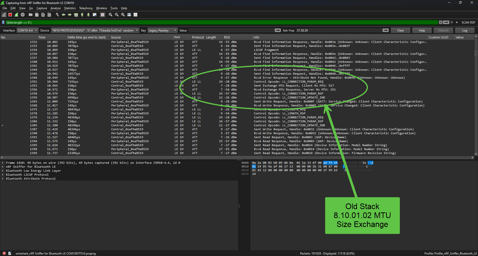

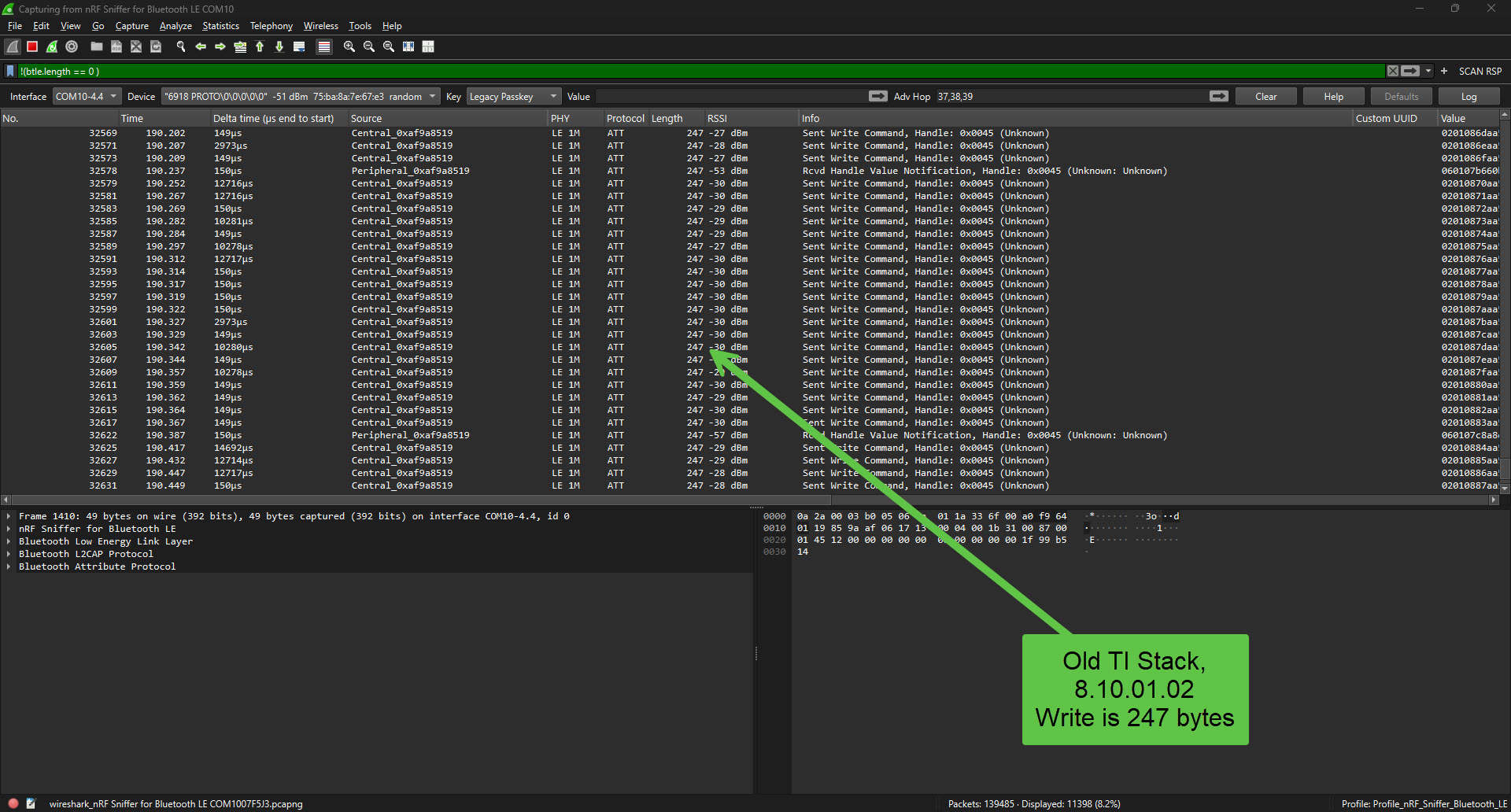

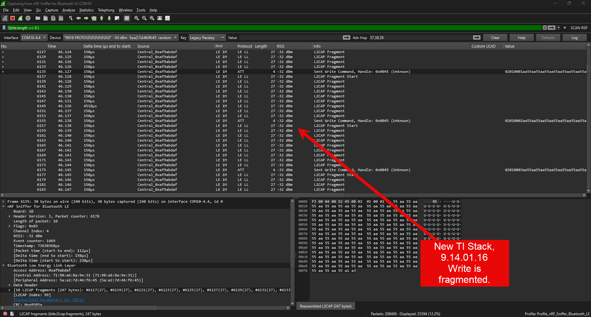

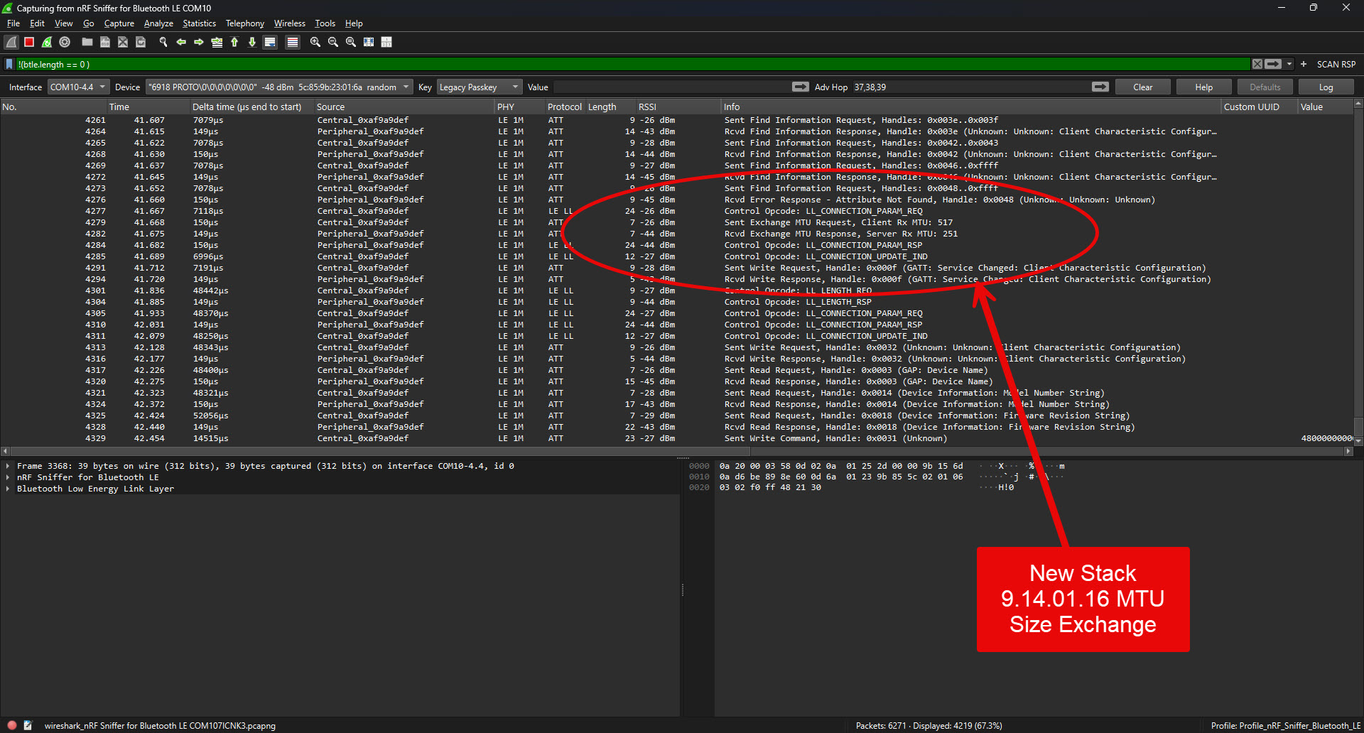

I've just ported from Stack 8.10.01.02 to 9.14.01.16, but now experiencing problems in our peripheral utilising large PDU 255.
It seems that despite the request to PDU size of 255 the cental ( Phone APP  ) just fragments the packets. I have defined the PDU correctly in SysConfig. I can the slave
Has something changed between the stacks as to how this is managed.
Here are some wireshark captures showing the problem and also the initial MTU size exchange for stack version. I can't see anything wrong there?
  • A little more info I have got from the trace...
    Currently it looks like the Central (Phone) - is sending LL_LENGTH_REQ with correct size for TX and RX, 251 bytes but the response from the Peripheral is MAX RX Octets : 27 and MAX TX octets 251.

    I have managed to use wireshark to look at the big data transfers. When the Central does a READ_REQ the Read data is a large packet and works, however when I try to do a WRITE_REQ  (which you did provide a example trace log for) - the peripheral seems to lock up without responding.
    It is indeed the WRITE which we need to check as these are the transfers getting fragmented with the latest STACK from what our devices now show.

    Okay so I managed you get your two projects running and using a 241 bytes payload data. Corrected memory allocations and caught characteristic 53 in the central to write a larger data block. As the demo you had only ever wrote a single byte.
    The overall result is it demonstrates the same issue I have in our project whereby in one direction Central ReadReq (PERIPHERAL to CENTRAL )the 241 bytes of payload is sent in a single interval, but in the other direction  Central WriteReg (CENTRAL to PERIPHERAL) the payload is fragmented into multiple transactions of 27 bytes max.
    The MTU setup is still exactly as you had it.
    This confirms there seems to be an issue in these latest SDK's with the LL size one direction.

    After digging more, I was able to identify the exact commit that caused the issue. This bug was introduced when trying to fix another bug when CODED PHY was used, but we did not realize until it was released that it caused another issue.
    The issue you're facing is on every DLE exchange, the connMaxRxOctets and connMaxRxTime values are updated to the effective value of the connection. This causes an issue where those values can only go down. At the start of your connection, these values are low due to the central using 27 bytes for the TX, making the effective value for RX 27 bytes for the peripheral. The value is then set as the max value for the peripheral and is stuck that way.
    There is currently an unmerged PR that would fix this issue, I'm gonna give more attention to the issue and ask the team responsible for the BLE stack to merge the PR as soon as possible.

    Here is the sniffer showing the fragmentation still occurring when Central writes 241 bytes to peripheral.
    Any thoughts? Do you have a sniffer log of the actual Write_Req ?
