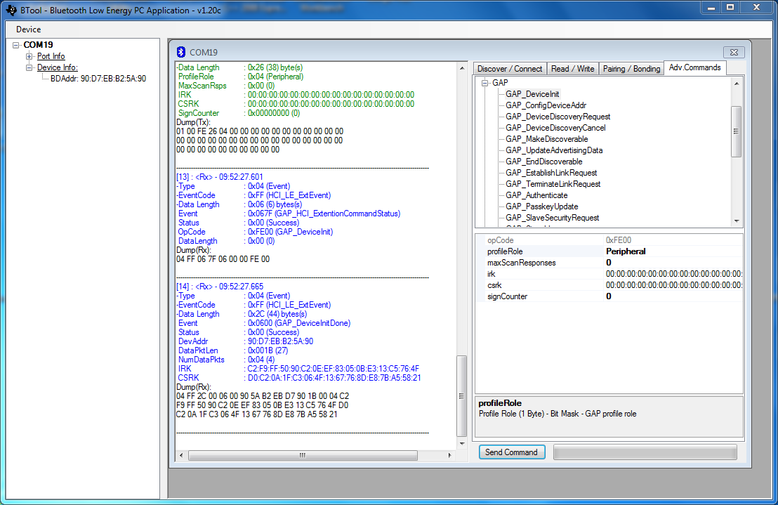

    4 - Run BTool, and choose the port COM corresponding to your USB Dongle. When you run it, it automatically configure the CC2540 USB Dongle as central, so you have to configure it manually as Peripheral (you can do it because you have build the project with the 2 possible configuration Central + Peripheral)
    5 - Under Adv. Commands tab, click on "GAP", and than "GAP_DeviceInit", and below configure the parameters like this :
     SEND COMMAND

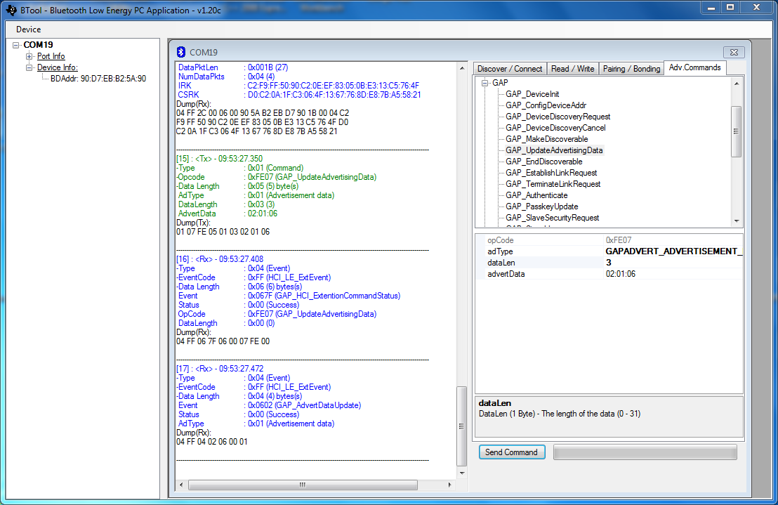

    6 - click on "GAP_UpdateAdvertisingData" and configure the parameters like this :
    SEND COMMAND

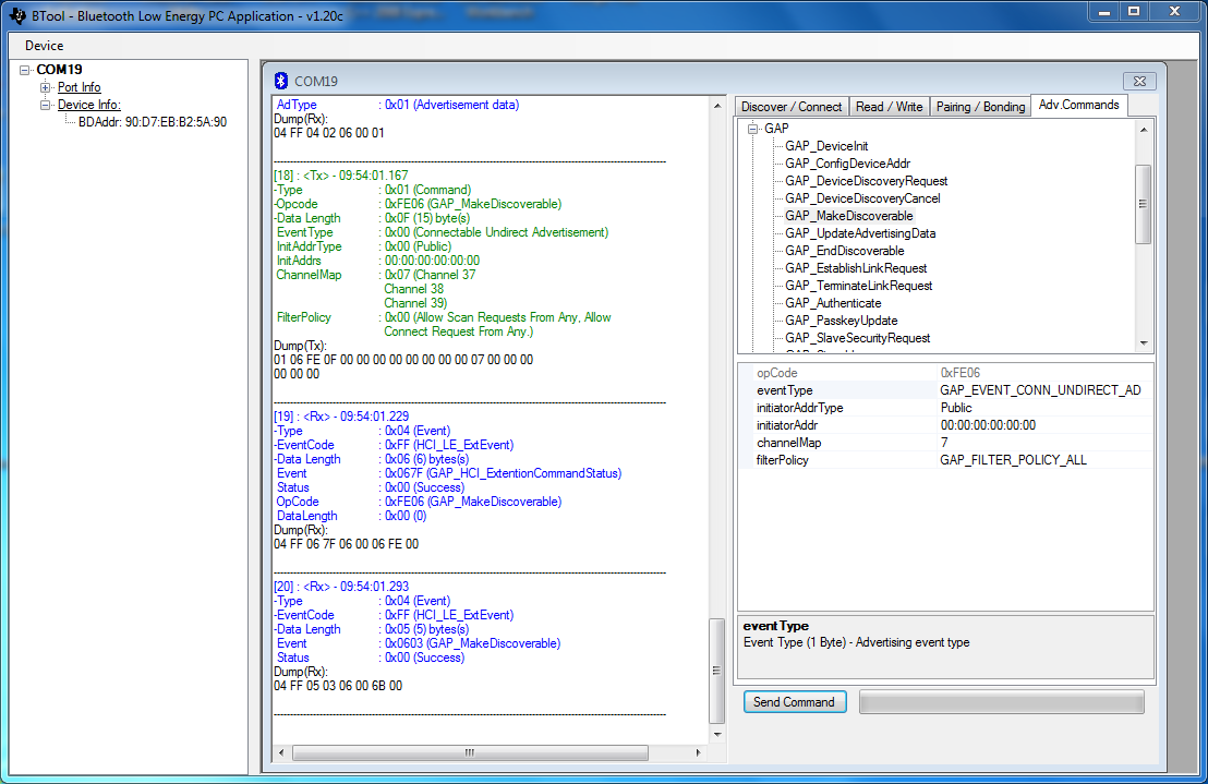

    7 - click on "GAP_MakeDiscoverable" to make it discoverable :) and configure the parameters like this:
    SEND COMMAND
    You can now scan with another Central CC2540 USB Dongle and you will see the CC2540 USB Dongle that you have configured in the slaves list.
