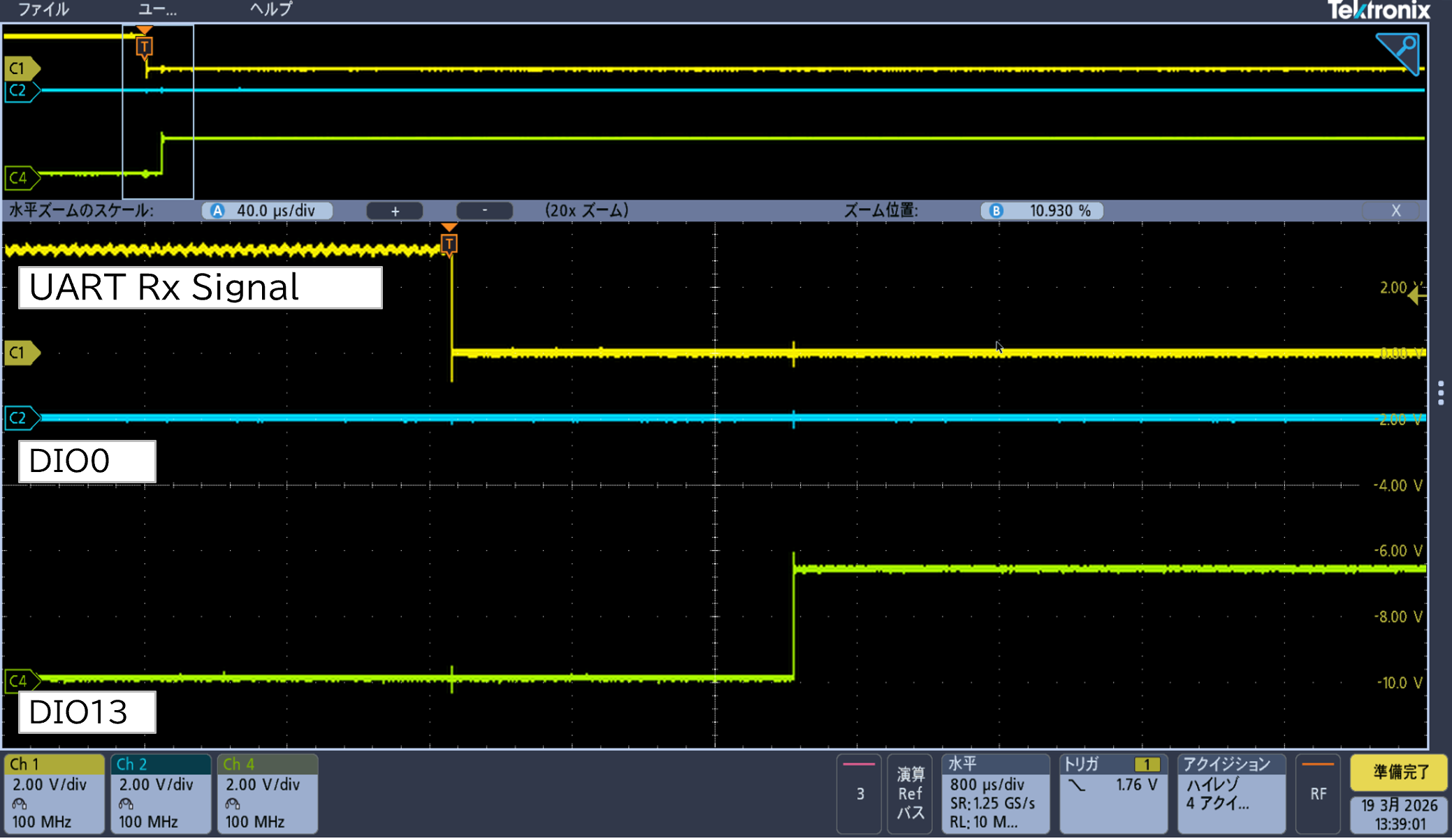

I am using the CC2340R5-Q1 and developing software with SDK version 9.14. Currently I am developing a product for a customer and implementing/verifying UART functionality. As part of abnormal-condition checks, I intentionally input malformed data and want to decide how the software should respond when the CC2340R5-Q1 detects an error. To do that I am investigating how the CC2340R5-Q1 detects UART errors. I have observed the following behavior:
  • When receiving UART data that has no stop bit, the event callback function is not called. Instead, the read callback function is invoked.
  • In the read callback function, the status is reported as normal/OK.

 I will attach the code I checked and the oscilloscope waveform for your reference.Thank you for yourhelp.

    Yes, the way your code is written the event callback should be called for framing error according to the API design, but due to a limitation in the UART driver that interrupt does not currently work.
    The RX callback is trigged due to an RX timeout event so yes this is expected behavior.
    To detect this error, I would suggest creating your own error checking in the RX callback.
    You can check the UART register error status using the API UARTGetRxError. This will return the error status in the UART_O_RSR_ECR register. The possible values this can return are listed in uart.h.
    doing this will allow you to handle the error as you want.

  • Hi Josh,
    Thank you. Following your instructions and making the code changes you suggested, I was able to detect the abnormal status and identify the error details inside the read callback function. However, I have two questions to confirm:
