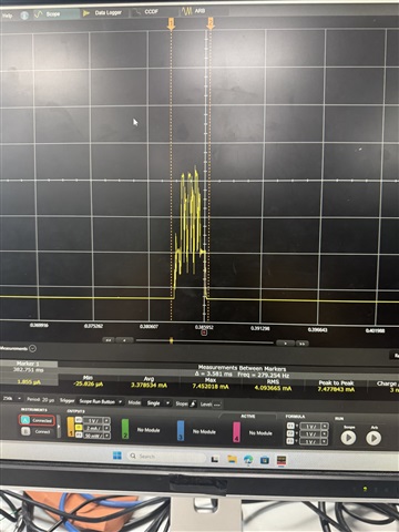

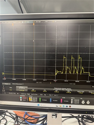

    My sincerest apologies for the delay. I just ran some power measurements on the CC2340R5 running a slightly modified basic_ble example and I saw an average current consumption of 140 nA when the device is in standby and 3.37 mA when the device is advertising (at 0 dBm).
    Here are the modifications I made:
    1. Go to RF Stacks Section -> BLE -> advanced settings -> Disable Display Module
    2. Delete Display instance found inside TI Drivers Section
    3. Delete all GPIO instances found inside TI Drivers Section
    4. [Optional] Go to RF Stacks Section -> BLE -> Radio and change the Tx power value to -8 dBm for the ultra low power (default is 0 dBm)
    5. [Optional] Go to RF Stacks Section -> BLE -> Broadcaster Configuration -> Advertisement Set 1 -> Advertisement Parameter 1 and modify the minimum and maximum interval values for less frequent advertisements (reducing the overall power consumption)
    I hope this helps.
