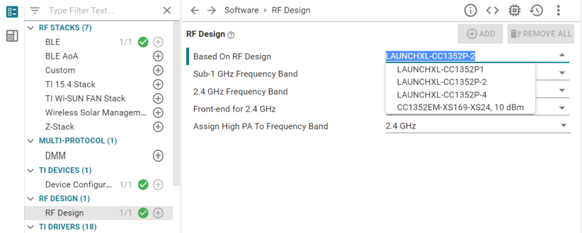

  3. For the firmware in sysconfig, we can't select CC1352PEM-XD7793-XD24-PA24 under "RF Design > Based on RF design". What should we do about that?image.png

    3) Please select the LAUNCHXL-CC1352P-2
