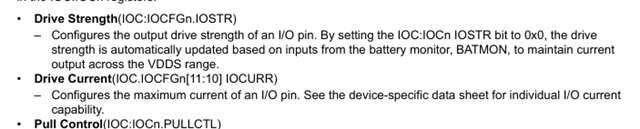

What's the recommended drive strength (IOSTR) setting when using the 8 mA drive current setting?
Is the recommendation to use the max drive strength? Or should you just leave it in Auto?

    Yes this is possible to configure a pin with drive strength using sysconfig, but it is also important to actually write out what the recommended settings are for this since not every customer is using sysconfig, and then it requires everyone who looks at this post now to go into sysconfig and configure a GPIO to see what it spits out.
    For what it's worth, Sysconfig seems to leave IOSTR on "auto" as a default unless you ask it to reduce the slew rate:
    Which also if you look at the TRM description of this feature:
    It's not really clear which one ends up controlling the current sourcing or sinking capability of the pin. Sysconfig seems to imply that IOSTR is just controlling the slew rate, but the TRM seems to imply that to actually get 8-10 mA out of a high drive pin across any supply voltage situation (whether or not that is advised is up to the user to decide) you would need to override the auto setting for IOSTR and set it to maximum. Or is the TRM saying that somehow the auto setting automagically does this for you?
    Thoughts?
    Munan
  • Also I just realized further down that list there is yet another field for slew control, so I don't think the sysconfig tool ever touches drive strength, just drive current. So then the question really is just what is the difference between the two bitfields IOSTR and IOCURR

    The actual file that has the sysconfig related defines is GPIOLPF3.h, in this find:
    #define GPIO_CFG_DRVSTR_LOW_INTERNAL  (IOC_CONFIG_DRIVE_STRENGTH_2MA)
    #define GPIO_CFG_DRVSTR_MED_INTERNAL  (IOC_CONFIG_DRIVE_STRENGTH_4MA)
    #define GPIO_CFG_DRVSTR_HIGH_INTERNAL (IOC_CONFIG_DRIVE_STRENGTH_8MA)
    Sysconfig abstracts it:
    Setting sysconfig GPIO to strength to medium sets the ti_drivers_config.c GPIO to GPIO_CFG_OUT_STR_MED
    which then is abstracted to
    #define GPIO_CFG_OUT_STR_LOW  GPIO_CFG_DRVSTR_LOW_INTERNAL
    then you can find in the ioc.h file this:
    //! \hideinitializer Manual mode, 8 mA drive strength
    #define IOC_CONFIG_DRIVE_STRENGTH_8MA (IOC_IOC12_IOCURR_CUR_8MA)
    //! \hideinitializer Manual mode, 4 mA drive strength
    #define IOC_CONFIG_DRIVE_STRENGTH_4MA (IOC_IOC12_IOCURR_CUR_4MA)
    //! \hideinitializer Manual mode, 2 mA drive strength
    #define IOC_CONFIG_DRIVE_STRENGTH_2MA (IOC_IOC12_IOCURR_CUR_2MA)
    // Automatic mode is not supported on this device
    #undef IOC_CONFIG_DRIVE_STRENGTH_AUTO
    The above shows our four modes (including automatic) which means this should be IOSTR which also happens sets the current (IOCURR), so yes sysconfig does set the drive strength.
    You can likely also set the register directly using:
