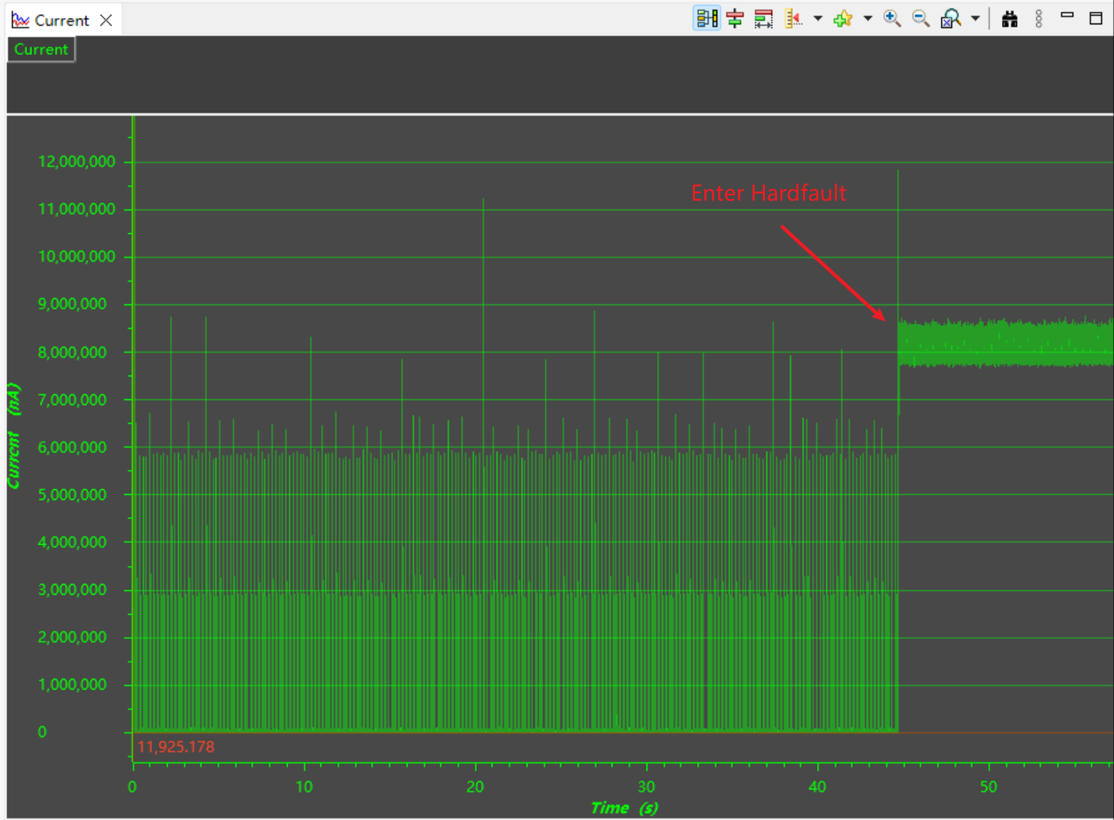

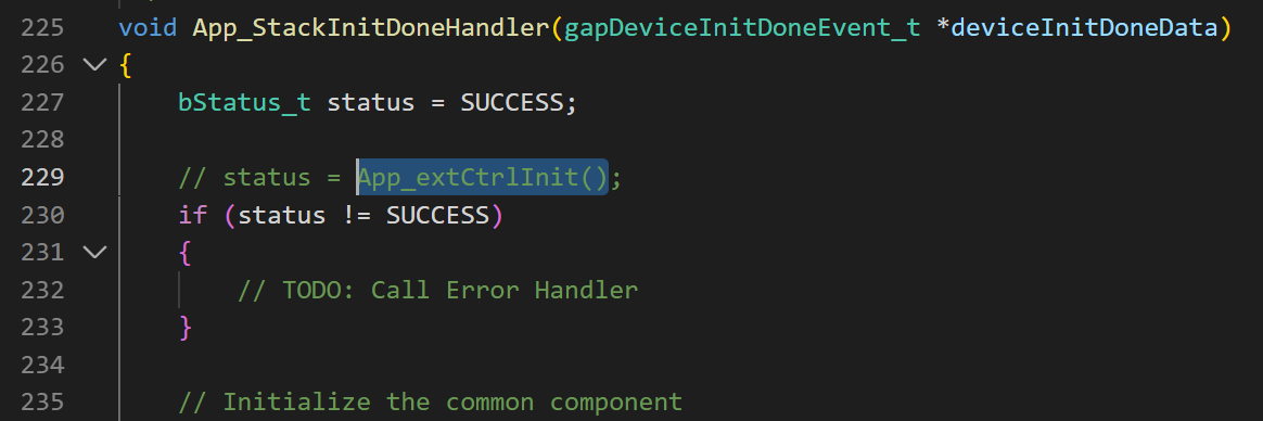

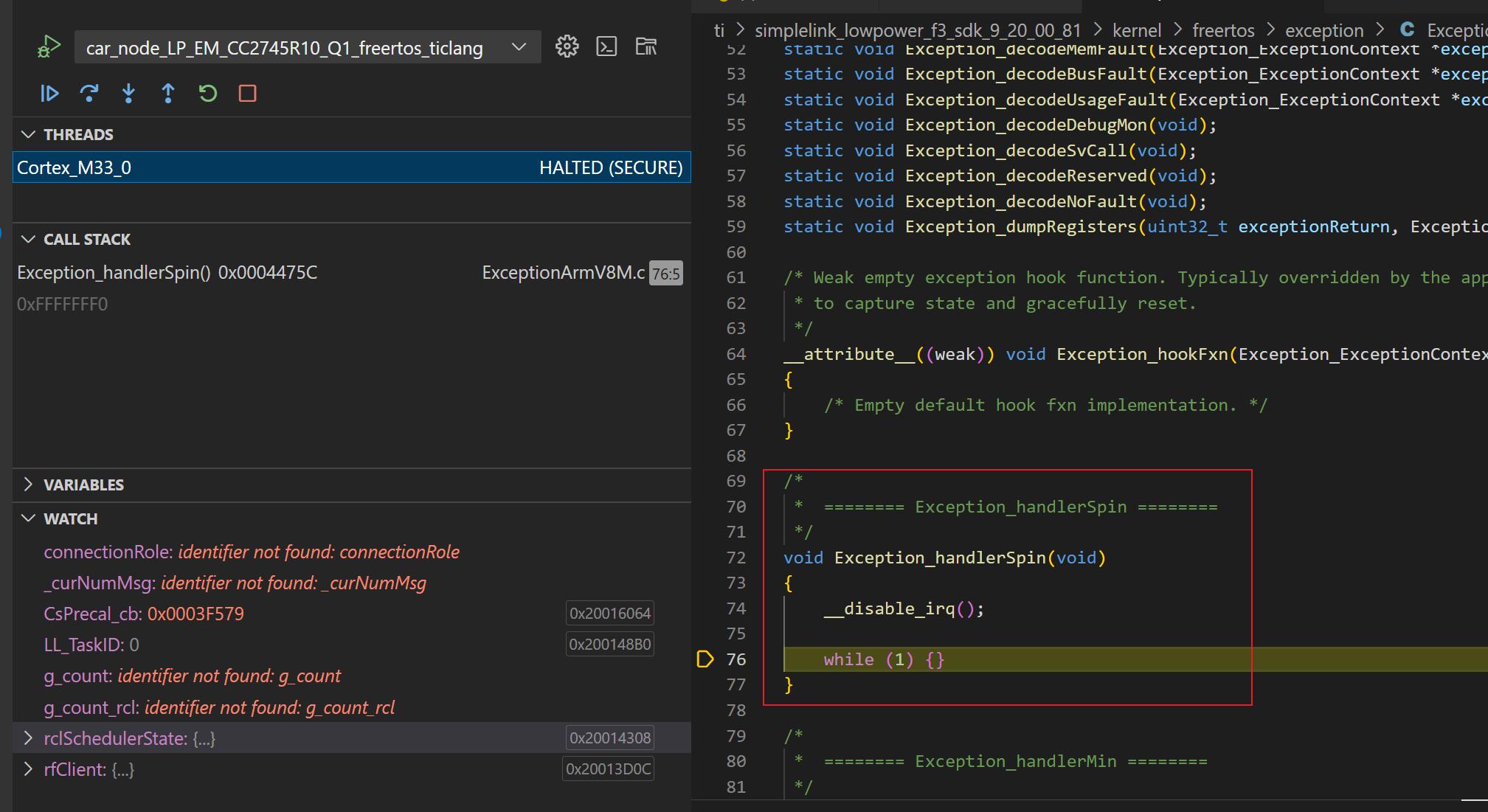

I found something wired. When I comment the App_extCtrlInit() to test Standby on Car Node, sometimes it will enter Hardfault with no specific time(30s ~ several minutes).
