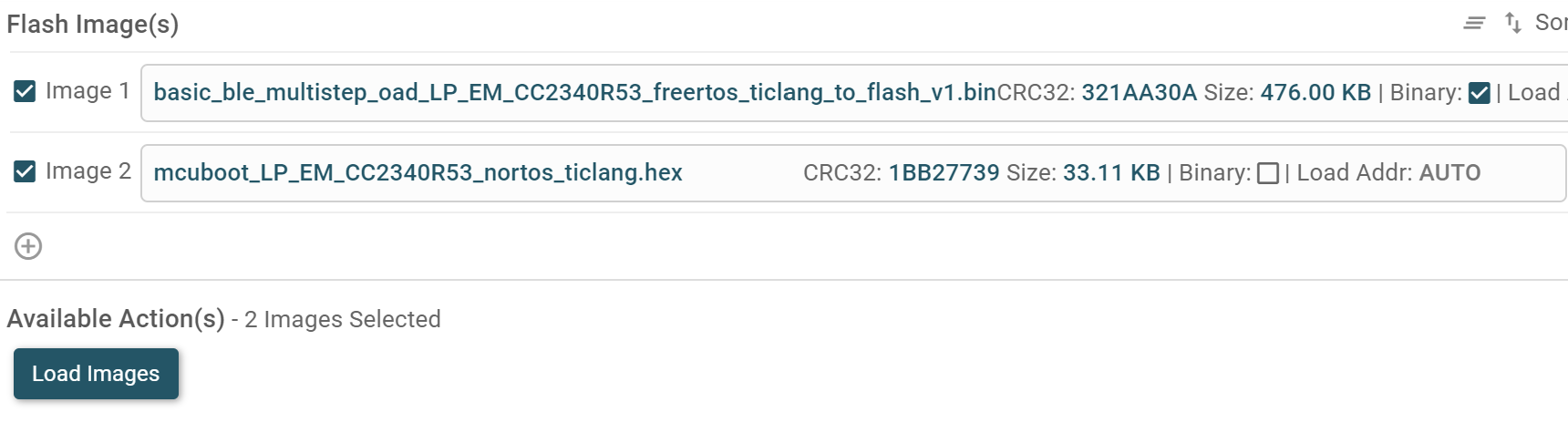

I used Multistep_OAD example project to test the OAD feature as belwo:
  1. Download the basic_ble_multistep_oad_LP_EM_CC2340R53_freertos_ticlang_to_flash_v1.bin and mcuboot_LP_EM_CC2340R53_nortos_ticlang.hex firstly, and after that the CC2340 can work.

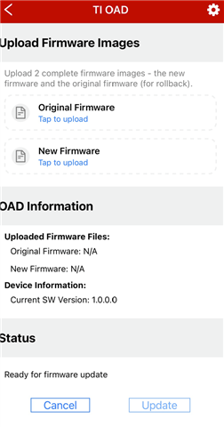

  2. Use Simplelink connect Apps to upgrade the CC2340 over the air. Original Firmware used basic_ble_multistep_oad_LP_EM_CC2340R53_freertos_ticlang_to_flash_v1.bin New Firmware used basic_ble_multistep_oad_LP_EM_CC2340R53_freertos_ticlang_to_flash_v2.bin. Clicked the update button, the OAD process is normal.
  3. but after the reset the CC2340, the chip still runs the old version FW.

  • Hi !
    In the first screenshot, I do not see the address in which you are loading the binary. Could you confirm the address at which you are flashing it ?
    I'm working on an SLA on how to do exactly the same thing as you are doing, so I will update you with the steps as soon as I can.

  • Hi Lea,
    Because I used an incorrect MCUBOOT.hex file, used below hex can OAD successfully, thanks for your support!
    ${SDK}/examples/rtos/LP_EM_CC2340R5/ble/prebuilt_hexfiles:mcuboot_dual_image_LP_EM_CC23xx, mcuboot_offchip_LP_EM_CC23xx, mcuboot_onchip_LP_EM_CC23xx.
