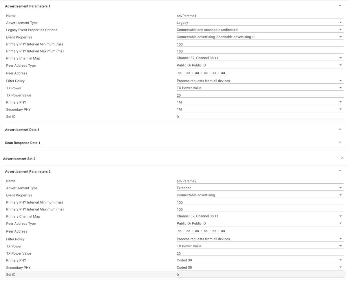

Hello everyone!
We are running a PCB based on the Launchpad CC1352P1-2 (the 20dBm circuit). It has the CC2652P and a DC/DC converter to 3.3V in front of it. We have configured our firmware to have two advertisement sets: One at 1M phy and one at coded-8, both at 20dBm:
We then took a power profiling measurement and were quite surprised by the fact that some peaks, especially all of the longer coded8 advertisement packets, only go up to 45mA.
The current consumption at 20dBm is 85mA. We asked Claude about this and it suspected that for regulatory or overheating reasons, the chip automatically backs of to around 14dBm in some cases.
Is this true? Can you please give us more details about this?
Thank you for your help and kind regards,
