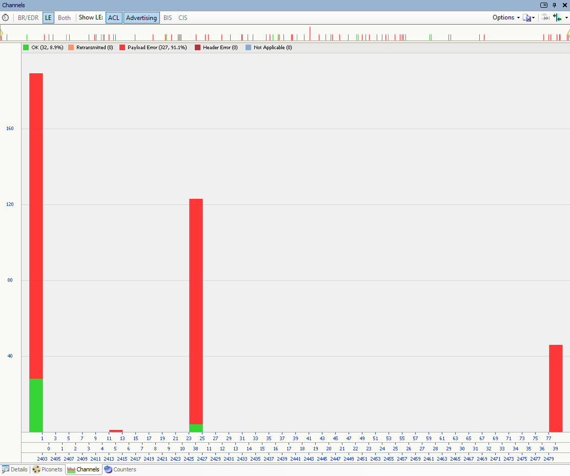

we have a multi role application and are facing several Scanning and Advertisment issues.
The device does not reliably find peripherals and advertisement packets are transmitted very sporadically and often with a corrupted payload.
The Issues occured after a change on the PCB design. But actually the HW changes did not concern the BLE part or antenna on the PCB, there were only changes on wired buses and the Touchdisplay.

  • Sebastian,
    As per your description and considering that nothing else changed on the Bluetooth design, it seems the PCB changes might have affected the CC2642 supply voltage (VDDS). I suspect that, when the radio is powered on to perform either Tx or Rx, the additional current draw might be causing a voltage sag on the VDDS line and causing either instability or reset/brownout. An additional aspect is to consider any assembly issues in your new prototype revision.
    To validate this theory, I would use an oscilloscope to probe the N_Reset, VDDS and VDDR pins to verify if the voltages are stable and free of noise.
    Apart from this, you can use the methods shown in section 6 of the application note below to verify the operation and stability of the crystal.
    CC13xx/CC26xx Hardware Configuration and PCB Design Considerations (SWRA640)
