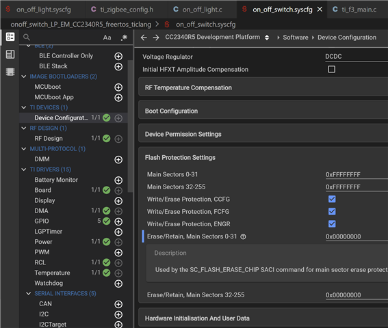

    I'm afraid that using the eraise/retain field in CCFG is not exactly useful for our use case. We would like the application to be updated, without erasing the bootloader. But we would also want the reverse: We would like the bootloader to be updated, without erasing the application part of the flash. So, if we set in the CCFG to not erase the bootloader section, such that we can solely update the application, we can't solely update the bootloader anymore as it is write/erase protected...

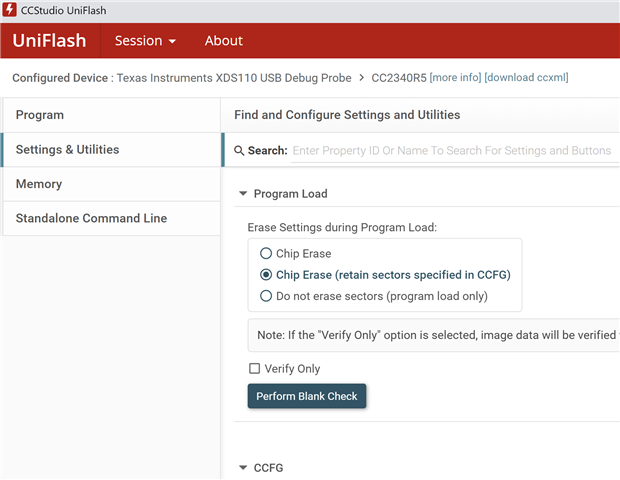

  • Thanks for clarifying.  For the use case you've described, would "Do not erase sectors (program load only)" support your needs?
    Ryan
  • Hi Ryan,
    The problem here is that I do need to erase the application part before I can flash a new version of the application. But in that case the bootloader part should not be erased.

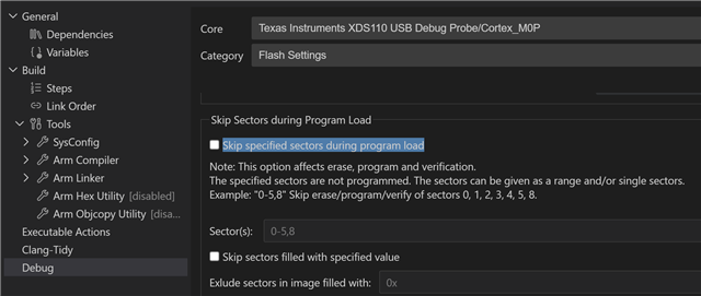

  • Have you tried the "skip specified sectors during program load" option?  This option is included in both CCS and Uniflash.
    The CC2340R5 supports flash sector erases, so it should be possible even if outside the typical tools.  Or you could choose to read the existing bootloader memory, mass erase, and re-program both the new application and original bootloader sectors.
    Ryan
  • Hi Ryan
    I would indeed expect this to be possible, as our custom bootloader can erase and program the application. However, when I try your suggestion by setting skip sectors 60-128, these sectors are still being erased.
    It seems as if it still mass erases the flash.
