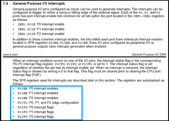

    Does that mean I can not set interrupt on Port 1 because I do not see P1IE definitions in ioCC2540.h.  My application needs to have interrupt on P1_0?
    ~LD

  • P1IE is IEN2 bit4. Do you have the CC2530/40 user guide?

    I was under the impression that if "P0IE" is an interrupt for Port 0, then I should be able to see P1IE interrupt for port 1.  The IEN1 that Kazola and you pointed out has bit 5 for Port0 but I dont see for port 1 or port 2.  The manual I am using is "swru191c".

  • As per my previous post it is in the IEN2 register. Note that IEN0, IEN1 & IEN2 do not correspond to port 0,1,2 respectively. Have another look at the user guide (page 43 of SWRU191B).
    Note that many of the system register bits are not mapped in the ioCC2540.h file, you have to either create it yourself the same way as other registers
    SFRBIT( IEN2    ,  0x9A, _IEN27, _IEN26, _IEN25, P1IE..............
    or simply write the value e.g.
    #define SET_P1IE IEN2 |= (1 << 4)
    #define CLR_P1IE IEN2 &= ~(1 << 4)
    As for the BV(5), BV(x) is a macro equivalent to 1 << x, so BV(5) = 1 << 5 = 0x20 which sets bit 5 but clears all other bits

    Thanks for your inputs. I do see the problem now.  I was searching for the keywords based on the attached file..
    <swru191b.pdf pages 78 & 79>
    I assumed that when a file is named "ioCC2540.h"; it should contain the entire hardware map or at least indicate in the file itself.
