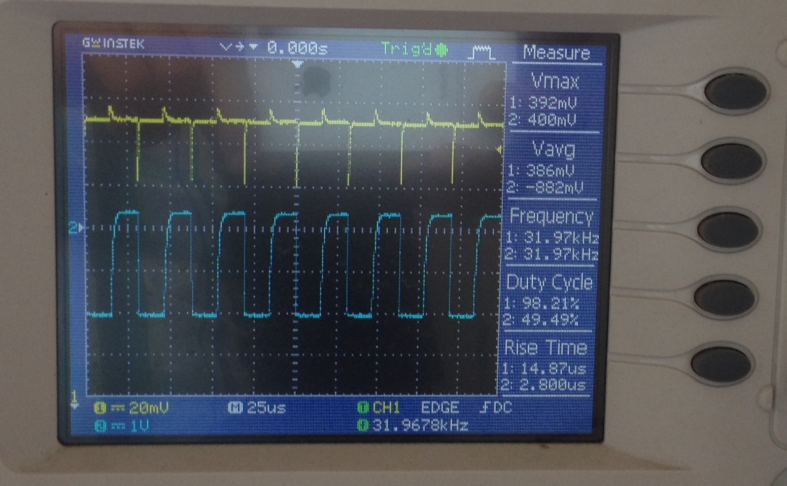

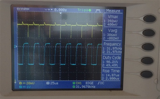

  • Hi there,
    i am trying to connect Gyroscope (L3GD20) with CC2541 through I2C communication. Im using TI Keyfob Sample program for the same but unfortunately i am not able to establish communication with the device.
     we tried to capture SCL and SDA(in while loop) from the ports on CC2541with out any slave connected(attaching the same for your reference). But with the slave connected, we are not able to recieve any acknowledgement from the slave after start condition.
    please refer to the I2C code that we have implemented for our slave Gyro and let me know if any corrections to be done for establishing basic I2C communication link.
    im also attaching the code for your reference
