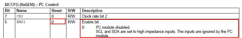

  • Hi, Thank your firstly.
        I have read cofiguration of I2C moudle from CC2541 SoC user's guide. The register for cofiguring the I2C moudle show as follow:
    And I have found that there is no code to cofig the I2CCFG register in my project. So the I2C moudle is disable default.
    Is there any other wrong with my project or hardware?  Thanks.

  • Hi, Thank you very much for your careful reply.
    I have found the problem. I use the CC2540 evaluation module from TI. I found the SCL(PIN2) and the SDA(PIN3) were connect to ground.
    I change them to NC, the current drawn rightly.
    But there is a question troubles me. The I2C moudle has been disabled, the current still drawn from SCL and SDA, why?
    Well, the cc253x/4x User's Guide states that disabling I2C module won't reset module's configurations. So the SDA
    and SCL pins were probably configured as inputs with pull up, which means you got additional current draw of
    2*(~3V/20K) = ~300uA?

  • Hi Leo,
    If pins 2 and 3 are connected to ground you must make sure to disable the I2C pull-ups. These are not disabled by turning off the I2C-module.
